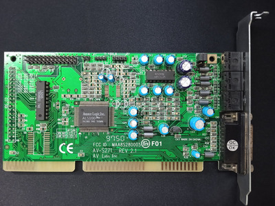

This Card also appears to have a QSound QX2130 QXpander chip onboard. From a quick look up this is a sound processor? Does this do some sort of effect processing?
QX2130 features:
Virtual 3D sound from ordinary audio signals.
Three enhanced modes:
- Pro Listening
- Wide Listening
- Wow for Games

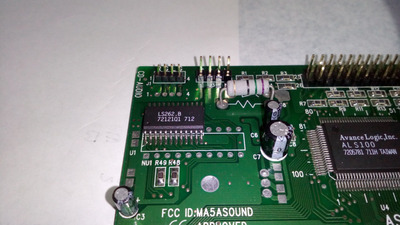

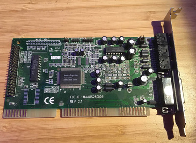

Reply 21 of 40, by Bancho
mkarcher wrote on 2020-06-28, 10:43:
Bancho wrote on 2020-06-27, 20:06:
This has what appears to be a Motorola LS245 20 Pin chip on board. Is this an OPL clone? […]
No, that one is the real 74LS245, an 8-bit buffer chip. You can be sure because 8 pins on one side of that chip are directly connected to the ISA data pins. That does not fit for the OPL clones, but is the usual application for a 74LS245 as ISA data buffer.
Do you think it would be possible to add Genuine OPL3 to this card? There appears to be a empty location above the LS254 which looks to have the same pinout at a YMF262
Reply 22 of 40, by gdjacobs
Bancho wrote on 2020-07-08, 11:11:
FM is most likely being provided by the CS9233 chip (along with wavetable). Changing that would require redirecting some traces and finding a place to put the OPL3 and DAC.

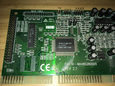

Reply 25 of 40, by Thermalwrong
Here's an ALS200 with a similar "LS245" chip 😀
682.21 KiB
1861 views
GPL-2.0-or-later
I have yet to plug it in, but according to the multimeter, every pin of that "LS245" chip links up with that footprint of where a YMF262 chip would fit 😉
1.06 MiB
1861 views
edit: huh, the PCB layout is the same as the 1st picture in the 1st post, cool.

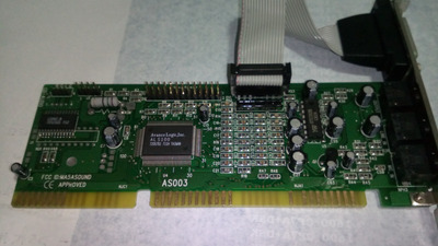

Reply 28 of 40, by Imperious
Thanks for this info. Here's a couple of pics of a card i got off ebay a couple of weeks ago.
    649.32 KiB
    1818 views
    699.49 KiB
    1818 views

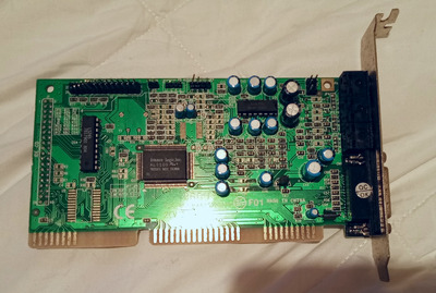

Reply 36 of 40, by ayandon
This is my card.
So, do you suggest upgrading the card by installing the Yamaha YMF262 IC and removing the fake IC? Pls suggest.
I want to restore my late father's 1st ever computer IBM ET&T PC-XT that he gifted me.
Hope you will be kind enough to guide and support me to restore his loving memory.
Reply 37 of 40, by mkarcher
ayandon wrote on 2023-08-10, 18:33:
This is my card.
In my oppinion, there is no reason to do so. The fake FM chips are unlicensed but verbatim copies of the YMF262 IC, so while they were cheaper and Yamaha didn't get their licence/patent/whatever fee for them, they should sound the same.
Reply 38 of 40, by Nunoalex
Great detective work !
I know this thread is 4 years old but I need to ask two things
- Can you repost the picures? they have been removed on the original post
- I have a similar card that found on a scrap yard and someone removed almost all the inductors
Is there a way to know the inductors values ? a schematic ? or are they more or less the same values ?
I would like to repair this little card
Here are pictures of my card with the "suspicious" LS 245 chip
thank you
