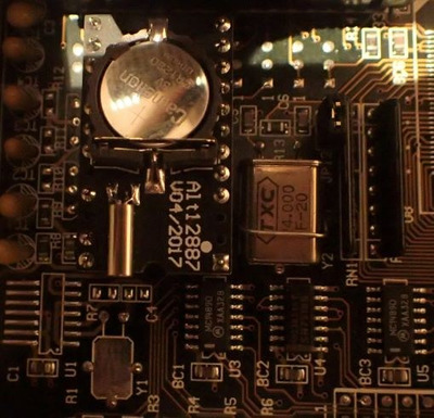

If you solder there a 8bit slot it will work - it will barely fit as the drive cage is in the way. Some small XT-IDE or some small card to add a boot rom should fit .
I even bought some 8bit isa slots from mouser last year but I abandoned the idea since that special card's idea was conceived.
The lack of expandability really hurt the system....

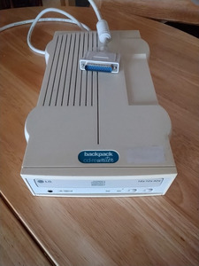

keropi wrote on 2020-07-14, 21:07:
how will you connect the external cdrom?
backplate of card is pretty much full atm though...
I've decided to go with a Backpack CD drive that connects through the LPT port. I had thought of attaching to the IDE, but it requires cutting and when I thought about it the LPT option would be easier and meet my needs, so there isn't much point doing any modification. The drive will only do 2x speeds as the Amstrad's LPT port is only Bi-directional and will eat a little RAM when it's plugged in, but that will be good enough to install games and run CD voices/audio on "talkie" adventure games of the time which is all I want it for. I've got a later model which is a CD-RW (I'll never use the RW function in DOS !), but wish I had the earlier version as the case style matches the Mega-PC so much better - still as I'm not going for a fully anthentic look, I think I can live with it for now 😁
Yes, thought that might be the case, the card is packing huge functionality into a single slot, frankly I'm amazed you've got as much in as you have - it'll be an amazing piece of kit 😎 I think I may have a solution to the cd-audio problem though, so don't worry about adding an extra one - I've remembered I have an old Yamaha speaker stored in the loft somewhere which has two line-in ports. That would allow me to connect the CD-drive to one port and the Mega-PC to the other and do the mixing on the speakers - that's probably a simpler solution to the problem, so will have a dig around some time and get them out when I get a chance........

Ah , a LPT cdrom... how does it perform? does it bring the cpu down on operation?

Yes seemed like the best plan - with the Amstrad LPT port I'm getting data rates of slightly above 300KB/s which is 2x CD-ROM speed - not exactly blisteringly fast but good enough. The drive does have an impact on the CPU when its in use, but I haven't fully measured it yet. When it's not doing anything or playing CD audio then there isn't a noticable impact, but when transferring data there is an impact. Just from the feel of things from what I've tried so far the machine performs more like it has a 25Mhz processor than the 33Mhz it has in - but for games such as 'Sam and Max' or the original version of 'Warcraft' its fine.

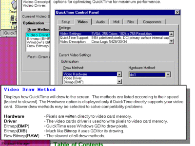

Myst? You might be lucky then. 😁 It uses QuickTime VR and QuickTime 2.x (16Bit) has direct frame buffer support for certain VGA chips built-in, too!
Just check the help dialog in QuickTime's Control Panel applet.

I never knew Quicktime had support for Cirrus Logic (shows how much I looked in the settings 😉) - that makes it important to get the graphics chip changed on my machine, especially as......

QuickTime 2.x can also use DCI if the driver supports it. 🙂
Display Control Interface was essentially Windows 3.1x-only (Win95 was planned to have DCI32, but it never really materalized).
Some movie players like Xing MPEG Player also use DCI. .

On the battery side - if the 386 one hasn't leaked then do cut it out asap - that said almost all of the boards I've seen up till now have had leaking batteries..... However the 486SLC is a better beast with a Dallas Clock chip and battery, so I'd definitely recommend pulling the old chip and replacing it with an Alt12887 (see pic) or similar since it allows you to remove and install the battery easily for storage - and a neater solution to modifying the Dallas.
55.39 KiB
