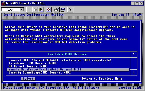

Are you aware of any other games that use XG? Cheers
Some late-era DOS games which use the Miles Sound System have it as a setup option. I just tried it with Heroes of Might and Magic 2 and it works great. That said, Heroes 2 also has CD audio music which is my preferred way to play it.
10.74 KiB
2073 views

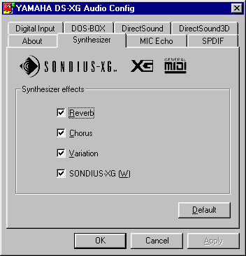

I made some XG recordings on the Fortissimo using the Yamaha XGstudio and YStation32 applications together with their accompanying .MID files. These can be found on various YMF7x4 driver CDs, including this one. Once again, Digital Out (via TOSLINK) was used for making the recordings:
For reference, the default soundbank that comes with the 1040 VxD drivers was used, and all the boxes on the Synthesizer tab have been ticked, including SONDIUS-XG. The midi files used were: Md30xg.mid (Fairy Tale XG), Ind31xg.mid (Industrial 50 XG), Tec30xg.mid (Technocrat XG) and Wiene.mid (Geschichten aus dem Wienerwald). The last track was taken from the SondiusXG folder, so I'm assuming it does make use of that functionality.
24.51 KiB
1713 views
