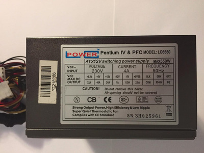

Finally got a better PSU. It's an LC Power 550W from the early 2000s and claims to deliver 40A on the 5V rail. And sure enough, my AthlonXP 1700+ now effortlessly boots at its proper frequency of 1466 MHz (11x133).
152.95 KiB
2453 views
The only minor issue with this PSU is that it only has one floppy power connector. This probably won't bother most people, but it matters to me because the SBLive front panel needs that connector as well. I've ordered one of those molex to floppy power adapters and hopefully that will do the trick.

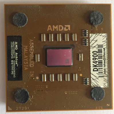

I'm posting a picture of my CPU since it's apparently one of the unlocked Thoroughbred models. It might be useful as a reference for people who are looking for one of those.

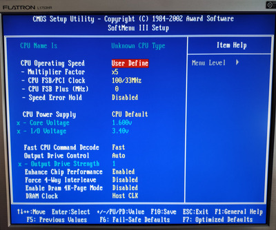

189.99 KiB
2013 views
Using the SoftMenu section of the BIOS of my Abit KT7A motherboard, I can freely adjust the CPU multiplier. Among other things, this allows me to downclock the CPU to 500 MHz. This is useful when dealing with speed sensitive games.

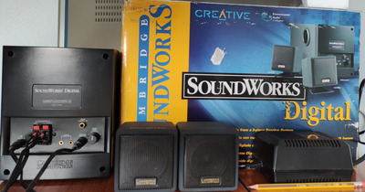

Somewhat unexpectedly, I got a set of NOS Cambridge SoundWorks Digital 2.1 speakers. They just randomly popped up on my local classifieds a few days ago, and since the price was fairly reasonable, I decided to go for it.
Contemporary reviews rate these speakers quite favorably, and I'm inclined to agree. The plan is to eventually use them with all of my DOS/Win9x rigs, but for the moment, they will remain hooked up to this system, mainly because I can connect my SBLive to them using a SPDIF cable. This produces nice, extremely clean sound.
One thing that I particularly like about these is that they use standard speaker cables for connecting the satellites to the subwoofer. As one reviewer put it, more companies need to follow suit, as it's so obviously beneficial. I love how this allows me to customize cable length according to my needs, and position the speakers exactly where I want them.

Overall, it's pretty clean. But I did notice some white noise if the volume wheel is turned above 50% when using analog inputs. It's very minor though.
On the other hand, when using the digital input (SPDIF RCA) there is zero noise, even at max volume levels. Here's a pic of the speakers showing all the inputs on the back of the subwoofer.
378.98 KiB
1879 views
BTW, the power brick that these things use is freaking huge! Pencil included for scale.

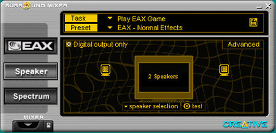

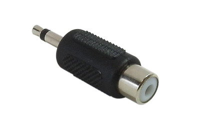

I recently read that it might be possible to get SPDIF Out from a SBLive through the orange jack using an RCA to 3.5 mm mono adapter (important: the adapter must be mono). So I got myself one of these (they are available on Amazon and other places) and decided to give it a try.
25.56 KiB
1757 views
As shown in the screenshot below, you need to tick the "Digital output only" box in the speaker setup under Creative's AudioHQ. That seems to be necessary for this method to work.
36.41 KiB
1757 views
With all that done, I was able to directly hook up the SBLive to my Cambridge SoundWorks Digital speakers using a coaxial SPDIF cable. This seems to be a nice alternative for people who don't have a LiveDrive but would still like to use SPDIF Out on their SBLive cards.
