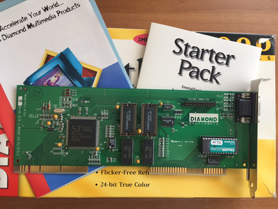

My Stealth 64 DRAM T VLB came with a mix of FPM and EDO:
412.42 KiB
585 views
Diamond Stealth 64 DRAM T VLB 2MB
Looks like it was produced around 96-97, which is fairly late for a VLB card, so the EDO support at that point in time makes sense.

Just because somebody stuck some EDO RAM modules in there doesn't mean the card is actually using it, especially if it's mixed with FPM RAM.
I thought EDO DRAM was first supported in Trio64V+, but I double checked the datasheets and the original Trio64 does indeed support it...but all of the Trio64 VLB cards I've seen so far use FPM DRAM, and I suspect jumpers or registers would need to be set to coax the card into EDO mode. Further examination of the datasheets is required.

Yep. My Trio64 VLB cards are all FPM (at least the soldered chips in the first bank). Checked 2x Diamond Stealth 64 DRAM and Spea Mirage P64.
But I have PCI Trio64 (86C764X) and even PCI Trio32 with stock EDO.
EDO operation can be checked/changed by running MCLK.EXE. But is usually programmed to BIOS on cards with EDO from the factory.
