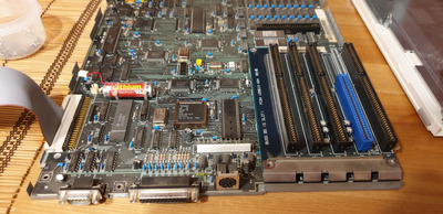

can someone tell me what this 60pin IDE Connector is for?
My Retrosystems:
K6-2 400 running Win98SE
P1-133 with Win3.11
Tandon 286-8MHZ Running DOS 5.0 on XT-IDE Card
Reply 2 of 14, by eisapc
From the location it is most probably a kind of proprietary memory expansion slot.
I might have to look in the manual of my PAC 286 for confirmation.
The board looks pretty similar.

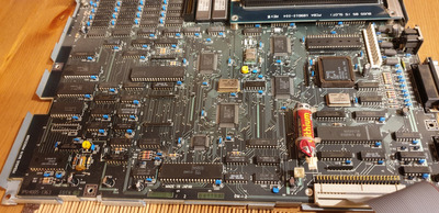

Reply 3 of 14, by GuillermoXT
Here are some other pictures of my motherboard if it would help
Thank you

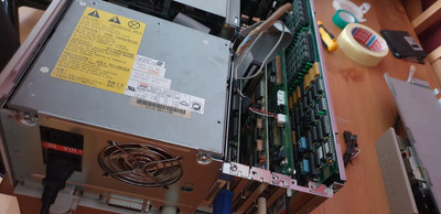

Hey my retrofriends ✌
Meanwhile i got my Tandon running. My issue for the bootloop the 286 had was the VGA was set as "bios Autodetect". I disabled the detection and it booted finally.
I swapped the RLL HDD out and inserted an XTIDE-CF unit with a 4GB Card (2x2Gb partition in DOS 5.0)....little bit Overkill i know ^^
Then I installed a 3mb ISA Ram module after searching without success for the proprietary Ram extension, swapped in a 10MHz Coprozessor found in a online flee market(German Ebay-Kleinanzeigen), a SB16 running Unisound (thx to Jaze Fox), an IO controller for the 4xspeed CD Drive (want to try if i can get the IDE header from the SB16 running to save a slot for a network Card),
a second 3.5" floppy drive and last but not least exchanged the LOUD PSU-Fan with a brand new one manufactured by Noctua. I newer saw such a silent 286 PC 🙂
There i one more thing I would like to change:
I know there has been a plus model with 10,7 mhz instead of 8MHz in mine....how did Tandon speeded it up without a 20MHz oscillator?
