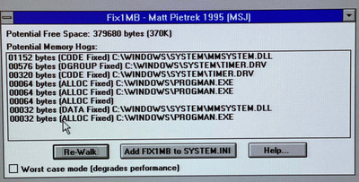

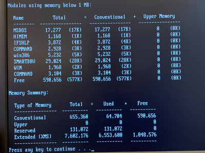

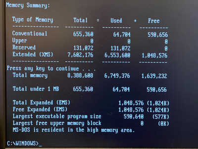

Attached are screenshots of command prompt run from within windows using mem /c /p
