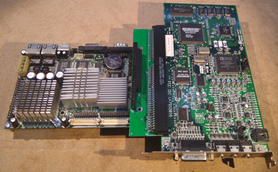

I've been playing with PC104 CPU boards recently and was frustrated by how expensive it is to plug an ISA card into them. Most adapters are more than $100 and that seems ridiculous when you could probably make your own adapter reasonably easily using IDC connectors and ribbon cable.
But I was doing a big PCB order anyway so decided to spend a couple hours knocking up some boards, cost each less than $20 :
977.25 KiB
3653 views
The small one leaves access to the main board but means that the card lies outside the PC104 footprint :

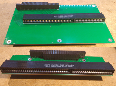

The large one sort of folds the ISA card back on top of the PC104 board and is probably more useful if putting the assembly in an enclosure :

I tested them and they work great! Here's a video of my old Ensoniq Soundscape Opus running on an Advantech PCM-5890 :

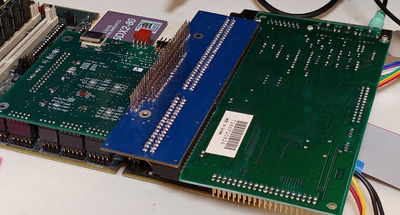

Just wanted to say many thanks for your work and for sharing the gerbers for this (and your other projects while I'm at it).
I'm in the process of converting a small industrial socket3 486 mainboard into a mini dos rig and I can now add a cheaper isa sound card thanks to this! (I'm using the smaller one). I may have a few left over spares if anyone is doing similar.

there's a url visible, on a photo, on the connector. Looks like a good source.
Do not ask Why !
Reply 7 of 17, by imi
rasteri wrote on 2022-06-09, 12:29:
imi wrote on 2022-06-09, 10:42:
where do you source the right angle ISA connectors?
Digikey... part number EBC49DCAN-S605
thanks, a bit pricey 😁
@weedeewee 🤣 I didn't even pay attention to that, yeah it seems the one on digikey is from sullins.
Reply 9 of 17, by dekkit
The SBC im working with can be found here:
Help with mapping out a Single Board Computer (SBC) - 486-DX2-80 - Innovative Technologies, Houston, Texas
It had zero documentation available for it, and very little written on the pcb. So I've slowly been mapping out the pins based on the datasheets for the IC s and making a few educated guesses based on similar era SBC and socket 3 boards (all my notes are documented in the link). Ive got it to a useable state now, so I'll finish documenting what I know and build a case.
As for parts for the PC104 adapter above (blue one in the pic above):
PCB = ordered via Jlcpcb ~$20 AUD x5 (small boards) posted via slow slow mail.
The sockets were cheap from Aliexpress (with a bit of research of pc104/isa layouts, mixing and matching of parts, and also bit of luck):
For the ISA part~ $20 aud (incl post)
5x "2.54mm pitch curved edge connector slot" (2x 31p)
5x "2.54mm pitch curved edge connector slot" (2x 18p)
- take note of orientation in pics.
For the IDC part that connects to pc104 ~$15 aud (incl post)
5x PC104 2.54mm Female stacking header for dual row..." (2x32p)
5x PC104 2.54mm Female stacking header for dual row..." (2x20p)
By far the hardest part was soldering the pins of the otherside of the pc104 (as its tricky to get the iron around when you have all idc rows next to each other) - so if I do this again, next time it may be easier to order single rows (ie 1x 32p) of female stacking headers.
So all up it was about $55 AUD for parts (which took weeks to arrive) and an afternoon of soldering to build 5 x units.
So significantly cheaper than buying an industrial adapter and perfect for my personal 486 gaming rig.
Hope that helps!
