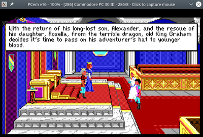

After taking a close look at a couple of Sierra video drivers, I have started to write a new one from scratch!
The result is a "PCPLUS.DRV" that provides full 16-color support on Plantronics compatible graphics cards:
38.66 KiB
4941 views
King's Quest IV demo in Plantronics mode in PCem
All source code is published under LGPL in my FOSS SCI Drivers git repo.

Alright. So I got hold of the King's Quest I SCI remake and interestingly, it will lock up even with the original color CGA driver copied over from King's Quest IV.
Maybe they added another function to the call table? Let's have a look...
EDIT: A quick look with a hex editor confirms that. The call table in CGA320M.DRV has 20 bytes, i.e. 10 entries.
Let's look further...
Reply 10 of 134, by Benedikt
That was easy!
This is a valid stub implementation for the scroll function:
mov     si,di
jmp update_rect
It doesn't really scroll, but CGA320M doesn't do that, either.
