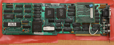

I think this nice card I got recently deserves its own topic 😉 Its a TSENG EVA/480 ET-2000 EGA card:

There a two add-on boards.
One connected to the feature connector providing TV-out. Dont know why the cable is soldered to the connector. As far as I remember it can also be connected via the feature connector without extra cable. Maybe to improve quality.
719.82 KiB
976 views
The other one...dont know yet, its not a memory expansion.
There is a Z80 and a HM6116 CMOS RAM on it.
https://pdf1.alldatasheet.com/datasheet-pdf/v … CHI/HM6116.html
The card seems to work without it.

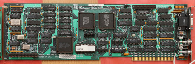

And without boards:

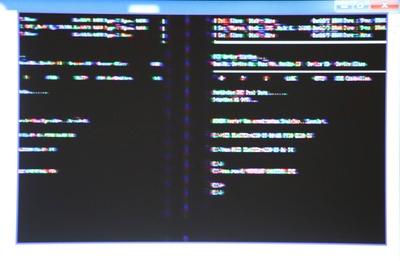

But is unusable with 640x350:
285.04 KiB
950 views
And all is in black and white. Dont know if this is caused by my LCD or if the circuit doesnt support color.
Digital out works as expected.

The black and white is probably because of PAL vs NTSC?

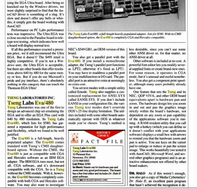

Oi. Came across this by accident, but that Z80 add-on is probably for register compatibility with CGA / Hercules / MDA:
"A $50 optional daughterboard provides emulation of the CGA, HGC, and monochrome adapter." - https://archive.org/details/PC_Tech_Journal_v … de/2up?q=ET2000
And from someone's ebay listing: "the Z80 CMII module ... (Compatibility Module) manages CGA and Hercules compatibility. " - https://www.ebay.com/itm/Vintage-1986-NEC-MUL … U-/133185245469
That's for the non-"480" version of the EVA ET2000, although it still seems to have some pretty interesting features. Any chance you have any of the software or documentation for this thing?

Yes, also found that info:
https://books.google.de/books?id=gC-DsOtl2MgC … A%2F480&f=false
No software or doc, card comes from a scrap lot 😉
