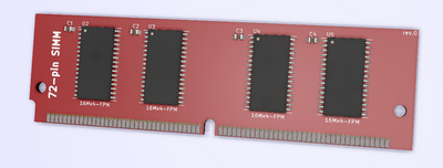

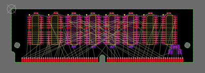

Reply 84 of 127, by wiretap
72-pin SIMM template: https://github.com/wiretap-retro/72-pin-SIMM-KiCAD-Template

Reply 85 of 127, by RayeR
OK, it could help a little bit to making a 36-bit parity SIMM. I have some JEDEC PDF with pinout and sch. of 36-bit SIMM.

Reply 88 of 127, by RayeR
Is your module wired to work also in 36-bit parity mode? Did you made there some size selection solder jumpers?

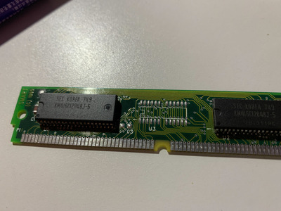

Reply 89 of 127, by mr-spain
RayeR wrote on 2022-11-03, 11:54:
Do you have a cheap source of high density 4-bit/16-bit DRAM FPM/EDO chips? I din't have any spare and I 'm a bit reluctant to solder them from old working SIMM modules.
This is not a parity compatible chip, the source is also not that cheap so I'd be sourcing more from somewhere else. I didn't have to change the size selector as it was the same size chips on the module. I'll probably souce more 50ns parts from high density simms on ebay or something.
Reply 90 of 127, by RayeR
The parity support doesn't depend on specific chip, normal DRAMs are used. As I see on your photo, your SIMM has two 16-bits DRAMs and one unpopulated 4-bit DRAM footprint so it would be enough to solder the 4-bit DRAM and you get 36-bit parity SIMM module. But maybe also ID pins should be changed. I don't know what schematics did you use. My goal would be to make universal SIMM that can be assembled as both 32/36-bits with different capacity chips selectable by solder jumpers to accomodate various DRAM chips that you can get...
Gigabyte GA-P67-DS3-B3, Core i7-2600K @4,5GHz, 8GB DDR3, 128GB SSD, GTX970(GF7900GT), SB Audigy + YMF724F + DreamBlaster combo + LPC2ISA
Reply 91 of 127, by mr-spain
RayeR wrote on 2022-11-04, 01:20:
Gotcha, yea that's a neat idea, I'd also use a side mount actual jumper as well so it' easy to change. Someone up thread kindly posted a template and I'm going through learning kicad to get the PCB's printed.
