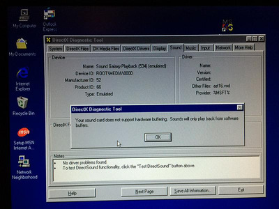

Hi , trying to run Slam Tilt on my cyrix 266 windows 98 machine with isa Reveal SC400 rev2 soundcard (drivers for win95 installed and sound works).
It runs great no problem except the sound has a lot of latency (when i press flipper button for example i hear the sound after 1 sec or longer) , anyone know if i can do something about it? maybe is because it has not hardware buffer and is emulated with the drivers? thanks!

Reply 6 of 7, by psy_
DxDiag says that my card doesnt support hardware buffers , that must be the cause of the lag 😒

Reply 7 of 7, by psy_
Changed the old soundcard with a Sound Blaster Vibra 16 CT4180 and sound works as it should now, no more latency problem, lost the real OPL3 for dos games with the old card but the sb16 sound nice too from what i heard so far , works alright in dos with creative CTCM.
