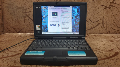

Now I have fully customized notebook with some upgrades and fixes:
  • Processor was replaced from 100 MHz to 133 MHz Pentium;
  • RAM was increased to max. amount 40 MB;
  • Broken Hitachi HDD was replaced with IBM DMCA-21440;
  • The CMOS battery was removed and replaced with an external CR2032 socket.
1.73 MiB

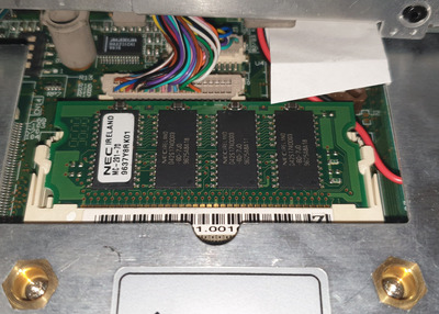

I bought an Olivetti Echos P133E notebook for 10$ with all these parts which I listed before. But the Olivetti's plastic is also in very poor condition (same issue with monitor bezel and hinges covers) plus CMOS battery corrosion on mainboard. After some inspection I decided to move all main parts (CPU, RAM, HDD) to my Acer.
Yes, I think it's a great success to find such rare RAM modules 😀. Here is 2x16 Mb modules from NEC brand:
849.4 KiB
117 views
