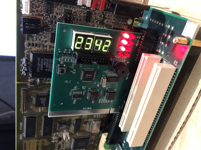

I've put an ISA Post diagnostic card in the board:
1.64 MiB
5637 views
and wrote to 0x80 and that works like it should, so basic I/O seems to work fine *hm*

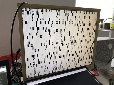

Good news:
VGA init seems to work now.
I've integrated support for this device into PCem (more specific, the tvga.c driver) and it's now directly controlling the real card.
This allows me to successfully initialize the card (and the VM can boot into DOS).
Unfortunately, writing into the video RAM does not work (yet). I have tried to write into A0000, B0000 and B8000 manually, but couldn't read my data back.
The screen is showing random data/uninitialized memory.

Reply 32 of 54, by manawyrm
digger wrote on 2020-09-13, 12:48:
Any idea what's preventing you from writing to the video RAM?
Not quite, yet.
I/O Read/Writes work fine, I know that because I can do all the Plug & Play stuff. Also, most of the VGA init (CRTC) works fine.
Memory reads also work fine, because I can read the video BIOS (at 0xC0000), which is using memory reads.
It might be either an electrical issue or some wrong init of the card.
I don't really think it's an electrical issue, I've checked with an oscilloscope and verified that the MEMW line is present directly on the card and looking correct.
I've tried to write some bytes at 0xA0000 and 0xB0000 manually and reading them back, which always resulted in 0xFF.
I'm not sure if there's some other I/O port I need to pass-through to the card to get it to map its video memory to my system memory.

Reply 33 of 54, by BloodyCactus
that means the memory isnt there, in the sense that ram lines are pulled high when non-existant.
I presume the card is doing its own ram refresh...
I also assume you meant 0xB8000 because B0000 will be locked off in text modes (depending) and read as 0xFF, so to for A0000 when your not in graphics mode etc.
Reply 34 of 54, by manawyrm
BloodyCactus wrote on 2020-09-13, 14:26:
I've tested the whole range between 0xA0000 and 0xBFFFF to make sure nothing works.
The RAM chips now get pretty hot (~40-45°C) after the init works, so I'm guessing that the refresh works as intended.

Reply 36 of 54, by manawyrm
Have you ruled out timing issues?
Not really.
I have a lot of delays in the code and the AVR is pretty slow in general.
The AEN and ALE lines could be part of the problem. I'm currently not using both of these, AEN is pulled low permanently, ALE is pulled high.
Additionally, the card might try to insert wait states.
Wait states are implemented correctly, the AVR will wait for the card.

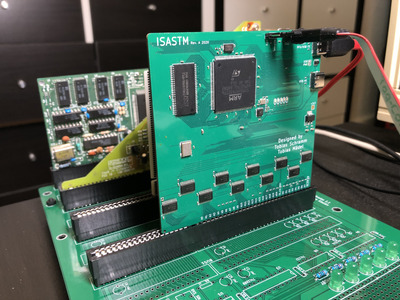

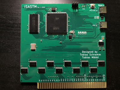

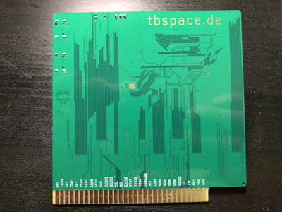

I've overcome my hesitation to deal with USB in order to get this to work properly 😀
This PCB ISA card is using an STM32H743 microcontroller to talk to the ISA bus.

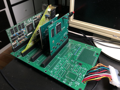

I'm using an already open-source and freely available ISA backplane to connect to other cards and to supply voltages.
The backplane PCBs are very cheap and ISA slots are very expensive (~4$/pcs!), so it makes sense to be able to swap out the ISASTM card without needing to buy another set of ISA slots for 30$.
1.79 MiB
5342 views
The STM32 is actually way too fast for the ISA bus when running at full speed, so I'll have to do some timing adjustments. For now, I'm running with -Og and debugging enabled, which slows the card down enough.
I'm still using the same serial protocol, but over USB CDC-ACM this time. This is nice because USB CDC is basically packetised data without needing to deal with libusb. I might still have to do that later (because "misusing" CDC ACM as a packet interface is an evil hack).
If anyone is interested, here's the PCB and firmware. Please don't buy any of these PCBs (yet), there are still some issues!
https://github.com/manawyrm/ISASTM

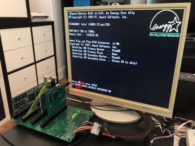

With the new setup (and some other code changes, mainly related to the memory write timing), VGA memory can now be written to:
1.61 MiB
5342 views
My modded PCem can now use a real VGA card, a real Adlib card, detect and initialize ISA PnP devices. I'm still missing software support for interrupts and DMA (but the hardware has support for it).
[Video] Using an Aztech soundcard in Adlib mode in PCem:
https://www.youtube.com/watch?v=0lqWBF858E8
[Video] Using a real Trident TVGA9000 VGA card in an emulator:
https://www.youtube.com/watch?v=5jW1dGRhmsE
The scrolling performance is pretty bad, because scrolling needs to copy the whole screen content one line higher in the video memory. As reads are done as single bytes and USB transactions are polled, this takes a while.
I could implement a shadow video buffer on the PC and just reply directly to VGA memory reads, but I would need to support VGA paging/memory layouts. (don't think I'll do this soon).
Tested and working video cards: ATI VGA Wonder 16, TVGA9000 and TVGA8900. Each with their own video BIOS directly mapped.
The USB interface is currently using USB FS (12 MBit/s), not High Speed (480 MBit/s). The hardware has a seperate USB 2.0 HS connector with the appropriate transceiver chip, but that one needs a bit of configuration to work and I've never worked with USB 2.0 HS or ULPI transceivers before, so this will need some fiddling.
