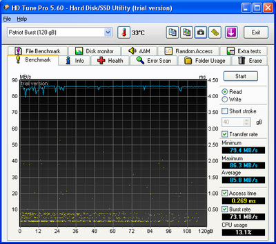

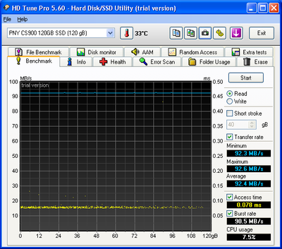

Reply 22 of 44, by Nemo1985
You are probably right, those are the results with another cheap ssd:
38.99 KiB
456 views

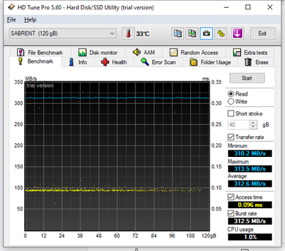

Same ssd connected with usb3\sata sabrent adapter to my main rig:
33.22 KiB
456 views
I find it curious that every sata device I connect give a tops the result at around 90 mb\s.

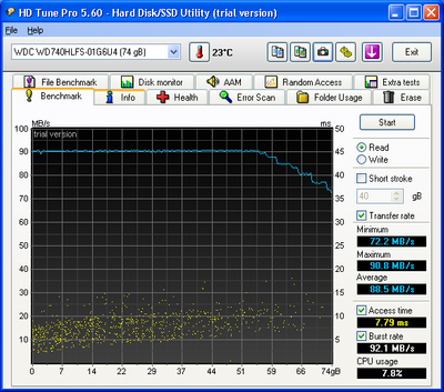

Wd velociraptor:
41.83 KiB
456 views
Again it tops at around 90mb\s...
So or the Ata-133 controller is flaky or the ide-sata adapter... Who knows...

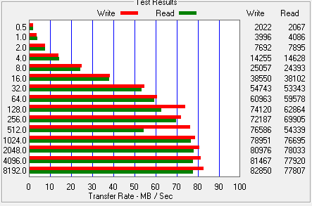

Reply 23 of 44, by Nemo1985
I've tested another sis mb, it is a MSI MS-6719 (MEDION) which use as NB the Sis 651 and as SB the Sis 962, i've been able to install windows xp in a ssd but guess what?
The result are sloppy as before:
43.4 KiB

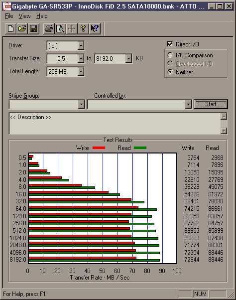

Reply 24 of 44, by The Serpent Rider
Ok, I've tried Gigabyte GA-8SR533P board with cheap chinese adapter and I've got similar results. Around 80-90 mb/s read speed on InnoDisk FiD 2.5 SATA10000. But sometimes I've got spikes up to 108 mb/s in some tests. So either SIS 962L aren't very fond of such adapters or IDE performance is somewhat inconsistent.

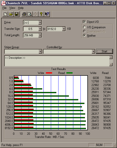

Reply 31 of 44, by The Serpent Rider
I'll probably check later how far I can push similar VIA south bridge with ATA133 support - VT8235.
Reply 32 of 44, by The Serpent Rider
Ok, so I've tested VIA VT8235 and guess what? Yep, it also can't reach ATA133 peak performance. Although it's mildly better than SIS 962L, with brief peaks around 113 Mb/s.
11.55 KiB
314 views
Ignore write speed, I've used another SSD which is still capable to achieve read speed above ATA100 - Sandisk SDSA6AM-008G
In conclusion, ATA133 peak speed isn't achievable from one device on such old south bridges.
