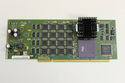

NCR 530-0041043 3415 SINGLE CPU PROCESSOR BOARD PBA 641365-002 for NCR 3415.
NCR 530-0041021 3415 DUAL CPU PROCESSOR BOARD PBA 630214-102.
Bought this:
https://www.ebay.com/itm/NCR-530-0041020-3415 … YkAAOSwvg9XdCtp

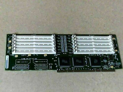

Can take one or two expansion memory cards, each bank takes 4 parity SIMMs at a time. Up to 3 banks, 12 SIMMs total on each card. I was careful to verify type of simms as there were several memory expansion cards with memory modules filled. These all has parity SIMMs.
https://www.ebay.com/itm/FUJITSU-625607-001-T … 872.m2749.l2649
There are 2 slots for processor card. Each processor card consists of single processor or another card with dual processors, up to 4 processors total.

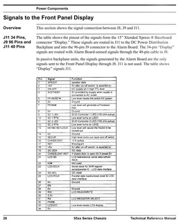

Here's the XX"15" front panel pinout (to whatever chassis distribution boards)
230.45 KiB
1101 views
from here
https://www.yumpu.com/en/document/read/290373 … -manual-radisys
Reply 10 of 15, by pentiumspeed
Wow, oh Thank you!, that's good one. So different.
I hope the board don't freak out without the alarm board and front panel hooked up.

Mr Slug, You are welcome, Full capacity is 768MB using 24 x 32MB FPM SIMMs across two memory risers, one bank is 4 72pin SIMMs as opposed to two on regular pentium machines. Due to early chipset, I think does not support EDO.
