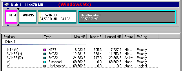

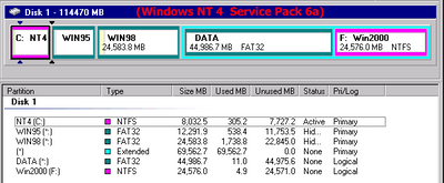

I am setting up a weird multi-boot setup using Norton PartitonMagic and BootMagic 8,
When I use PartitionMagic to set up the logical partitions in the extended partition, it sees them fine, but windows NT says they are unallocated, and vice versa.
The drive is 120GB, and the BIOS and controller work with it just fine.
I have NT4, 95, 98, and 2000, any NT based OS can see partitions made by each other, but not ones made by 9x based, and vice versa.
    9.45 KiB
    166 views
    9x not seeing partitions made in NT's Partition Magic
    12.15 KiB
    166 views
    NT's Partition Magic showing how they should look
Reply 1 of 4, by chinny22
This is mostly normal behavior
Win9x cant read NTFS partitions, which is why it comes up as unallocated.
Likewise NT4 can't read Fat32 partitions.
Dos/Win9x also struggles to understand more then 1 primary partition which I imagine could be causing issues as I would expect both your Win9x and 2k installs to be able to see your data partition.
Reply 2 of 4, by Cyberdyne
Extended partition type have some incomptibilities accross operating systems, best bet is just to make max 4 primary partitions, DOS, Win9x nd WinNT versions all see them, even if they do not understand how to read them. And if your extended partition is after 1024 Track boundary, more problems will arise. DOS before 7.1 and WinNT before 2000, are not LBA aware.
Reply 3 of 4, by andreja6
chinny22 wrote on 2020-09-15, 08:40:
This is mostly normal behavior Win9x cant read NTFS partitions, which is why it comes up as unallocated. Likewise NT4 can't rea […]
That's not the issue, at least in this scenario. In normal circumstances 9x displays NTFS as unknown and not unallocated, and same with NT4 and FAT32.
The double primary partition is invisible to 9x, and shows up as an OS/2 partition or something
Reply 4 of 4, by andreja6
Cyberdyne wrote on 2020-09-15, 10:23:
Gah, that's annoying. I wanted to have 5 partitions, NT, 95, 98, 2000, and a shared DATA partition between each OS. is there some way to get 9x to see NTs extended partitions right (or vice versa)?
