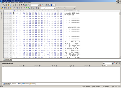

it's a little bit off-topic, but just in case it helps someone and because it's based on information posted previously in this very forum thread, using the approach I described here:
Re: About Roland Virtual Sound Canvas 3
today during my morning tea (i.e. it wasn't hard at all), I was able to find the address line scrambling of WaveROM 4 and 5 in Roland U-220, the C source code showing how the de-scrambling is done for WaveROM4 is attached (it's the same for WaveROM5), here is also how WaveROM 4 looks like when unscrambled:
45.74 KiB
1039 views
I did that just out of curiosity, because until now that semi-manual approach I described several years ago, I've used only on SC-88 and I was not actually sure if it's applicable for more general use or not. it seems so and after the first 8 to 10 bits of the address line scrambling is found, after that, it's astonishing how fast it's converging towards the solution.
