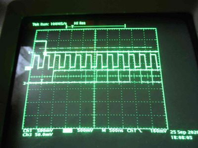

CleanWave32 is Dream's sample set found on some waveblaster modules like MIDITEMP DS48, but it seems to have a bug that causes digital overflow effect resulting in awful cracking noises when sound gets loud enough.
Here's the distortion :
FLAC : http://www.tmeeco.eu/BitShit/PCschit/ElkmoonBad.flac
OGG : http://www.tmeeco.eu/BitShit/PCschit/ElkmoonBad.ogg
SAM9733 chip has its audio output format in software control, and software lives in the sample ROM so I hooked up an oscilloscope to the DAC to see maybe it is outputting wrong format to the DAC and I found that there actually is a problem. Namely BCLK polarity is wrong, new samples are output on rising edge instead of falling edge, no DAC out there can accept this format and the result is that data changes while DAC latches it. Due to delays stemming from analog factors it essentially means the data the DAC sees is shifted left by 1 bit position, losing its MSB and that results in the cracking sounds as sort of digital overflow happens.

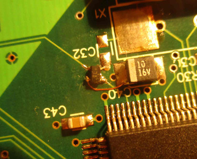

A fix is to add an inverter to the BCLK line, it will cure the distortion and will also reduce the loudness of the output by half, massively reducing clipping that happens in the analog stage after DAC on the WB card. Here's the fix :

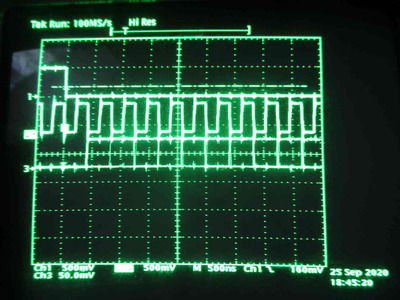

And the result :

Correct bitclock

CleanWave8 and GS sets do not suffer from this bug, it is strange such a thing went unnoticed or at least didn't get fixed...
Bonus fix on the MIDITEMP board is to change R11 and R21 to 4.7kohm, it reduces gain, clipping and also noise. I don't know why all these WB cards have so cranked up volume levels, there's almost nothing out there than won't clip with the insane levels used by most of these things...

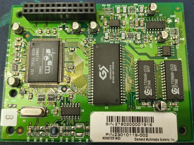

I have a Diamond Monster MIDI with the SAM9733 chip... I have noticed these unfortunate cracking noises/distortion happening particularly on loud notes. The difference is this board has a Dream GMS963200-B chip which is as I understand the Roland GS format 32 Mbit ROM and not the CleanWave32. Even though this is not CleanWave32 GMS973200, the crackling noises are very clear and consistent. Is it possible this bug exists on this card as well?
Is there any way I can modify my card similar to the fix above for the MIDITEMP DS48? But I'm not sure where the inverter would go.
Here is a picture of the board.

Reply 3 of 4, by darry
kinkong wrote on 2024-02-18, 06:34:
I have a Diamond Monster MIDI with the SAM9733 chip... I have noticed these unfortunate cracking noises/distortion happening par […]
You are likely hitting this other issue, which has a software fix also by Tiido.
Dream SAM9733 and SAM9407 based MIDI devices distortion fix
Reply 4 of 4, by kinkong
Running SysEx B0 63 37 62 07 06 4F as described in the fix from the other thread does reduce the volume level of the clicking, but the clicking is still present. I've also tried a lower value of 32 but it is still there albeit more quiet.

Setup:
- CHiLL V
- Roland UM-ONE
- MidiPlayer 6
- External USB DAC
Diamond Monster MIDI SAM9733 Roland clone soundbank GMS963200-B
- Clicking: (WAV)
Roland SCB-55
- No Clicking: (WAV)
MIDI File (found during 24 seconds to 34 second playback mark)
- JHELOM.MID
Possibly it is just my particular card... If anyone else has this card, or a Yucatan fx which I believe has the same chips, and can playback the Midi that would be helpful!
