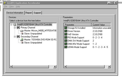

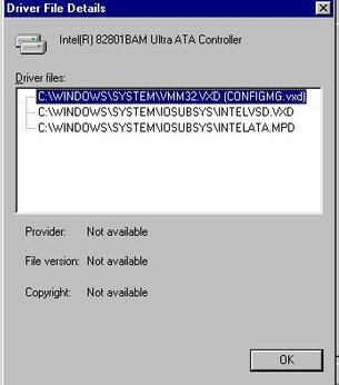

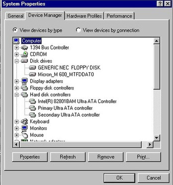

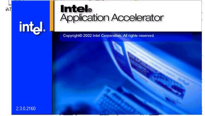

Unofficial Intel application accelerator driver. use at own risk.
You have to manually update the controller, primary and secondary. Run the Microsoft patch first as it fix a bug with cd players.

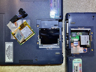

401 and 603 connection slot difference. Interesting that 401 uses a generic mini PCI card and can be replaced with wifi one, while 603 used smth different.

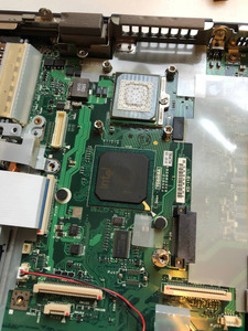

Warlord, does 402 models have a soldered CPU or it is in the socket?
186.55 KiB
380 views
I just cleaned my 603 and it is in the socket while some people stated that 2805 has soldered CPU.

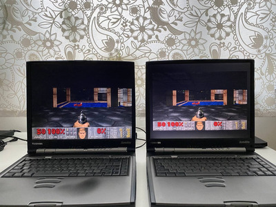

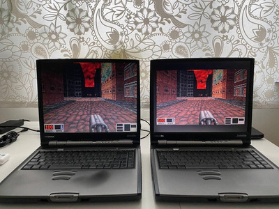

It's here! For a test, I've installed new LCD into savage laptop. It's brighter, but for some reason, it's not obvious on photos.
144.16 KiB
257 views

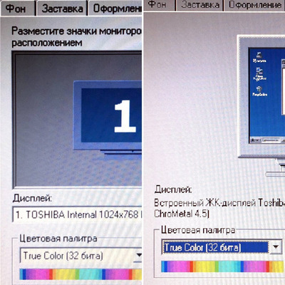

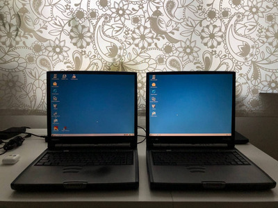

Also, i've taken some comparison photos of bad scaling:
180.99 KiB
257 views
186.92 KiB
257 views

Hi ! It seems brighter, yes !
But what about those differences in scaling ?

Scaling on laptops lay on videocard, not the monitor. So 100% avoid Savage videocard, only GeForce (2805-402 and 603). Savage will be good for an external monitor since scaling there lay on external monitor logic board, internal will have horrible scaling. Windows stuff looks extremely bad in low resolution:
