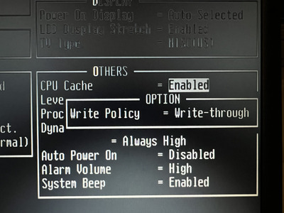

Guys, write-back or write-through? What’s the best? What’s the difference?
Write through gives you extra granularity in slowing down the CPU. Enabling write through policy + all slow down tricks I mentioned above might net you some where between DX33 and DX66 speeds. It might get you slow enough to play wing commander 1.
Reply 75 of 161, by MAZter
vorob wrote on 2022-02-12, 20:03:

Default write-back faster, you can check it using PC Player Benchmark 640x480.
Doom is what you want (c) MAZter

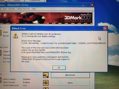

Warlord! Something bad happened. I’ve installed 3dmark2001se and it crashes on second test. And first one runs with artifacts and low FPS at the end. The error message is:
244.77 KiB
1159 views
Only in 16bit it works properly.
I’ve got another laptop with ati m6 and it worked fine in 32bit.

rest in piece, good thing you have 3 of them. side note 2001se It's a directx 8 benchmark and geforce2 go is only directx 7 with non programmable shader..

Can you please give a try on your sample? 3dmark2001se with default settings. I’ve tried another unit and it’s the same issue.
I’ve checked readme and it requires 32mb of vram. So it may be a source of a problem. But another my laptop with ati m6 and also 16mb of vram runs without an issue. That’s strange.
