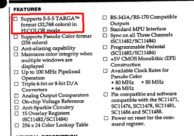

With 8-bpp RAMDACs - eg. KDA0476 or KDA0478 - it isn't possible to bypass the palette SRAM.
It's possible with HiColor and TrueColor RAMDACs, eg. SC11483:
43.75 KiB
263 views

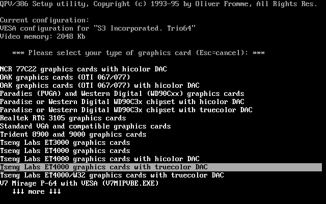

The utilities/dos drivers that seem to come with ET4000AX cards don't seem to supports higher color vesa modes than 8bpp no matter what ramdac you have and that applies to the version of them that comes with speedstar24 cards. Only way I have been able to get the higher color vesa modes to work in dos seem to be univbe. It would be nice if a version of vmode would exist that would support them that would have come with newer et4000ax card since they were made for quite long time.
There's software that can use >8-bpp via non-VBE modes, see eg. QPV/386 1.7e :
7.06 KiB
215 views
