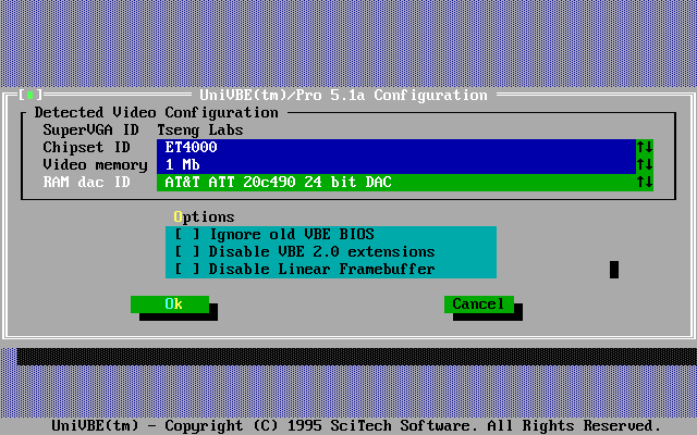

It should be possible to use >8-bpp modes even without upgrading the BIOS, by using UniVBE.
UniVBE is good at detecting the RAMDAC, and if not, it's possible to select one manually:
5.07 KiB
1045 views
Still, it would be a good idea to do the BIOS upgrade, as there's some software which uses non-VBE modes.

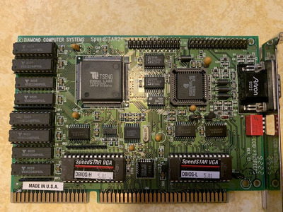

I happen to have 2 of these cards. One with 24-bit DAC and a second with 8-bit one.
24bit
8bit
They are identical, except a "made in USA" print.
The second card produces subtle and hard to describe with just words incorrect background color fill during palette transitions in some games. Where it should be black it is sometimes dark blue.
Not sure if this is because of the .01 difference in the BIOS between the two cards, or maybe it is the DAC. The problem is so minor that i never bothered to investigate.
Other than that i didn't actually notice much difference in picture quality, but i use them mostly on 286 and 386 class computers where 8bit graphics are the norm and there is a chance i missed something obvious.
