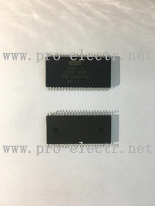

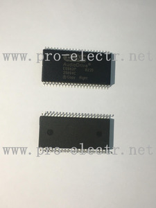

Hi. I want to modify some of my ESS cards to have wavetable which should be easy enough. Almost everything you will encounter have ES981P 1MB wavetable ROM but as I have recently discovered, there exist ES982 2MB ROM chips too. I have contacted a Chinese supplier and they sent me a photo of the chips they have. I would like to know your opinion whetever it is fake or not. To me, it looks repainted and as far as I know, there is no ES982P chip, only ES982A (SOP44) or ES982N (TSOP):

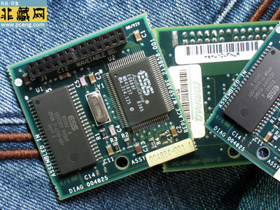

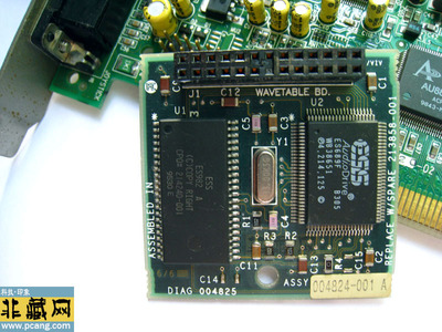

Probable originals:

Reply 3 of 28, by Tiido
At best they are functional lasered refurbs from scavenged parts, worst case non-functional stuff with random memory chip inside...
Reply 4 of 28, by imi
seeing as they're a different package (yes the first one, the indents are different) I'd be 95% sure it's fake.
looking at the markings... well those are definitely remarked x3
but then again, oddly enough sometimes chips came from different manufacturers in different packages.
Reply 5 of 28, by Paar
The distributor I've been negotiating with has been trying to convince that these are new and origianl. Lol. They said they'll try to find another batch so I'll give them another chance even tough I'm sure it will be just another fake. I'm really hoping I'll get my hands on these chips as I'm sure there is no recording of the ESS 2MB wavetable on this forum or anywhere else. Would be cool to compare it to the common ES981P.

It's 5$ per chip (I'm buying five) and 10$ for shipping... I'm hesistating. The font looks different than on the Compaq daughterboard and the ESS logo is badly printed. I'm still more convinced those are fake too.

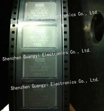

The 'glitter' effect on the ES918P looks like they've been blacktopped/remarked, but those ES982n look legitimate to my eyes. Both are likely to be working ROMs, but blacktopping is pretty much a given with out of production chips bought from China. I've been trying to buy some Yamaha FM chips lately, yikes.
The datecode on the ES982n matches the point at which wavetable ROMs would've still been in production, but had become irrelevant.

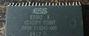

Well I got different offer and to me, it now looks like a real deal. The chip is scuffed and scratched and doesn't look repainted. On the other side the price is higher (15$ per unit and 30$ for shipping). I'll try to negotiate some discount and better shipping fee. Is there someone who is interested in the chip too?
