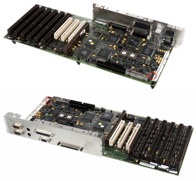

Reply 3 of 19, by PC Hoarder Patrol
If E10 is this one
638.4 KiB
552 views
I think it relates to use of the redundant power supply
