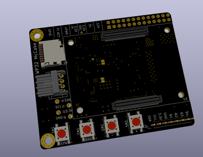

mothergoose729 wrote on 2021-02-24, 21:53:
Love this project! Feature request time!
Will there be ways to cycle ROMs for munt (CM32L, old MT32) as well as load different sound fonts from within DOS like you can with MDF and a midi PC emulator?
yes, especially as MT32 supports this, the new pcb there will have a 'SYN' button to switch between synth engines (MT32 or Fluidsynth)
and a 'BNK' button to cycle between ROMs (for MUNT) or soundfonts (for fluidsynth)
redesign almost ready, hope to have prototypes made soon.

bnz99 wrote on 2021-02-24, 22:29:
4 button pins: What if Dale decides to use the encoder button 🤣 I can see myself already modding an old case.
Dale definitely will use the encoder button soon, I'd strongly recommend adding a pin for it... 😉

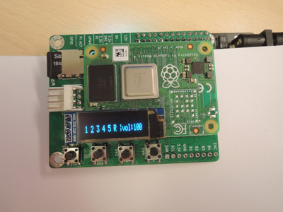

Latest revision works fine now,
with button and LCD support.
I will make a first very small run.
