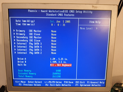

Baoran wrote on 2020-11-22, 01:02:
Would anyone happen to know any socket 939 motherboard that would support dual floppy drives? I have a good socket 939 build and I could just switch the motherboard if I found such.
I have a DFI Lanparty NF4 SLI-DR, which supports dual floppy drives. It also supports drive A & B swap.

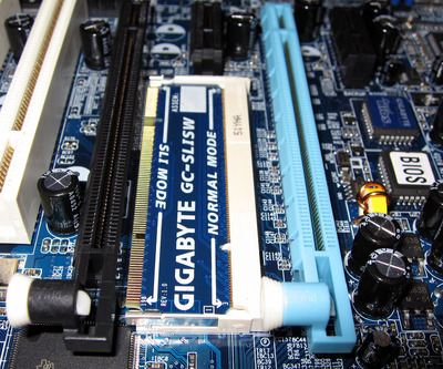

computerguy08 wrote on 2020-11-22, 13:52:
OT, but if I understand correctly, you need to manually set jumpers on the board to enable/disable SLI? I've never seen this before.

Errius wrote on 2020-11-23, 00:52:
Yeah, this is a thing of the early 2000s, the first SLI boards on the market always had those "SLI fingers", which electrically connected the two cards in x8 mode. The DFI board happens to use jumpers instead.
