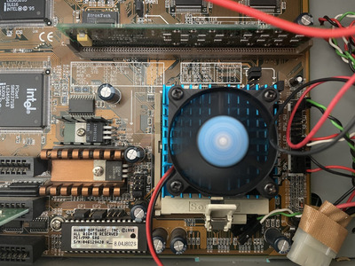

So I have this PT-2006 i430VX motherboard that came with a WinChip C6 200.
It appears that the jumpers on the board were configured for an Intel Pentium 200 MMX (see picture), using 2.8v core and 3.3v io.
However, the system did start with the WinChip but it was very unstable and even after setting the jumpers to 3.5v it either hanged or blue-screened on me.
So I decided to switch to an Intel Pentium 200 MMX, and set the jumpers to 2.8v core and 3.3v io (see picture)
It managed to boot once, but then it hanged in the windows98 desktop. Since then I haven't been able to boot it with the intel mmx. (no post, nothing on screen, no beeps).
The WinChip is still booting with this motherboard, but has serious stability issues.
Now on the board I saw 2 voltage regulators. I am assuming one for the IO and one or the cpu core.
I got the following measurements without a CPU :
  • The EZ1084AC always outputs 3.3v (I guess this is the IO voltage).
  • The EZ1083CT is setup as an adjustable voltage regulator, and depending on VR1 jumper outputs the correct cpu core voltage (2.5v, 2.8v, 2.9v, 3.3v, 3.5v)
  • Both are getting a clean 5V signal as input.
So these readings seem to be correct, albeit without load, so I decided to do the measurements again with the CPU:
With the intel MMX CPU installed :
  • The EZ1083CT outputs 1.4v
1.4v is defintely too low, and would explain why the system does not start and the CPU doesn't "warm" up. However, why would it output only 1.4v
With the WinChip CPU installed :
  • The EZ1083CT outputs 3.3v (regardless of the jumper settings)
Strange that it always outputs 3.3v and not taking into account the VR1 jumper settings (2.5v, 2.8v, 2.9v, 3.3v, 3.5v)
885.08 KiB
207 views
Any ideas ?
Reply 1 of 9, by computerguy08
I would suspect maybe the EZ1083CT is bad (from a previous OC or something like that) ?
EDIT: Could also be bad capacitors on that rail.

Reply 2 of 9, by evasive
Found datasheets for both of them.
Both have no voltage rating so are adjustable voltage.
Check the datasheets for the resistor values. You say the output drops to 1.4V, what happens on the input at that time? Is that still 5V? Oh and how clean is clean, did you check with an oscilloscope?
Reply 3 of 9, by RetroSpector78
computerguy08 wrote on 2020-11-22, 11:05:
Don't know much about the history of the system, but fact that the jumper settings on the board didn't match up with the installed CPU doesn't look great 😀
The WinChip C6 supports 1 of the 2 voltage ranges :
  • 3.52V (3.45V–3.6V)
  • 3.3V (3.135V–3.6V
Mine has 3.52 written on it so I guess it expects 3.45V - 3.6V. However with the WinChip installed its always getting 3.3v. Could that explain the instability (not enough voltage) ?
Will try to check the caps and the regulator. It is strange however that
  • It was able only able to boot the Intel MMX once and never again after that.
  • The output voltage on the winchip always being 3.3 while the intel it dropping to 1.4

Reply 8 of 9, by quicknick
RetroSpector78 wrote on 2020-11-22, 10:46:
This is the easiest to explain. Speaking off the top of my head, there are around 50 power (Vcc) pins on a S7 CPU. In the case of split power planes, those 50 are (almost) equally split between Vcc2 (core) and Vcc3 (I/O). Some S7 boards don't use jumpers for choosing single or split power planes, and instead rely on the (single-plane) CPU itself to short the two rails. So with the WinChip you're seeing the I/O voltage "spilling out" to the (most certainly defective) EZ1083's output, and the CPU is only powered by the I/O VRM, which is not good.
Hope you sort this one out and looking forward to see it featured on your great channel! 😀
