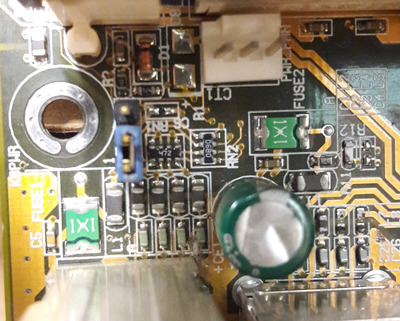

I finally found some time to have a closer look at the board again and discovered that there are some damaged SMD parts that I didn't notice before.
Measuring the voltages, it turned out that the PS/2 port voltage varies between +1.5V and +3.5V depending on the combination of different keyboards and mice that I plug in (the optical mouse that probably draws most power causes the voltage to drop to +1.5V). The USB ports get nice and stable +5.0V and both fuses are OK.
916.59 KiB
214 views
P5A damaged SMD parts near USB ports
In the above picture, R11 is defective. (R12 is missing, but looking on some hi-res pictures of the board online, it seems that it wasn't populated in the first place.)
Capacitors C27 + C28 and coils L9 + L10 are damaged, too. These clearly belong to the USB ports and shouldn't have any impact on the functionality of the PS/2 ports, but it explains why Windows wouldn't detect a USB mouse either.

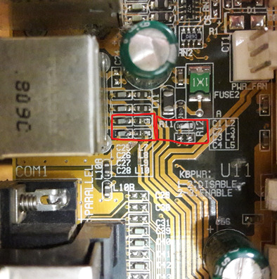

678.21 KiB
214 views
PCB area near PS2 ports
The parts near the PS/2 ports look OK though.
So I'd say a likely cause for the voltage at the PS/2 ports being too low is R11.
I'd like to go ahead and try to replace all the parts, but the challenge is that all the values are unknown... I am not an electrical engineer or something, so I probably wouldn't succeed in reverse-engineering the circuits to determine the correct values. All I can do is probably try out some random values and see if it works. *sigh*

Reply 5 of 7, by cyclone3d
The ones designated with L are not resistors but inductors.
I can measure the resistors on one of my boards.

Reply 7 of 7, by gex85
I replaced the caps and inductors near the USB port with some that I salvaged from the USB circuitry of a dead Mobo so the values should be more or less similar.
R12 was mechanically damaged and when I desoldered it, the solder pad came off so I had no chance to solder in a replacement. Since R11 seems to be in parallel to R12 though, I populated it with the closest match that I had at hand, 120 kOhm.
Nothing had changed in regards of PS/2 voltage being too low, so I poked around with the multimeter some more and discovered that L1 caused the voltage to drop from 5V to something between 1.5 and 3.5V depending on the devices connected. So I desoldered it and replaced it with an inductor from the PS/2 power supply circuit of the donor board - voilà, perfectly stable 5V at the PS/2 ports. Upon desoldering, L1 had broken into two parts immediately, so it must have been cracked before, causing the voltage drop.
