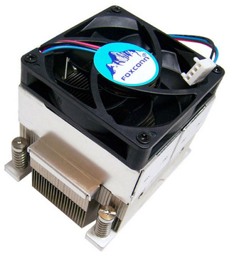

I went on eBay and found this cooler. It's a Foxconn CRSBW model 342291-001. Instead of the plastic clips, it has 4 screws.
Does anyone know if this screws directly into the motherboard, or is there some kind of retention bracket that I need for it?
Thanks.

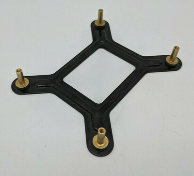

This is a picture of the screw-type backplate I found. The screw-type cooler I found is pictured in my earlier post. Is there a bracket that goes with this?
Thanks.

Reply 5 of 13, by PC Hoarder Patrol
Maybe take a step back, as on checking that heatsink appears to be designed for 533MHz Prestonia / Gallatin Xeon processors for the HP / Compaq xw6000 workstation, rather than skt478 (did you see a compatibility list that said otherwise?)

Reply 7 of 13, by PC Hoarder Patrol
Think the listing is wrong - these are designed for 1st generation skt 603 / 604 boards like those in the xw4000 & dual processor xw6000 workstations
