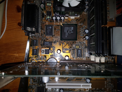

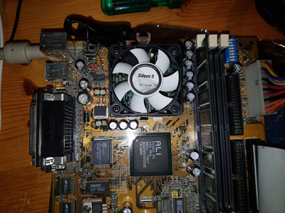

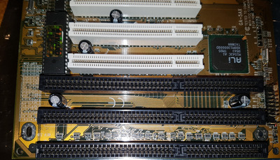

I have tried. Motherboard is very straight and clean. I have not noticed any bloated caps personally either. Here are some pictures I just took while trying to get something out of it.

Reply 5 of 26, by dionb
Which CPU are you using?
And exactly which beeps (how many)?

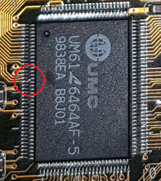

But looking at that (very good, sharp) pic there's something that might explain memory problems: it looks like one of the pins of the L2 cache chip is bent or broken:

Check if all the legs of all components are solid soldered to their pads.
It could be a bad bios too; and lower right corner of pic there's is a trace looking broken.
Could you post pics of the back?

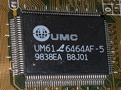

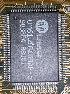

The Beep is single repeating long beep that repeats forever.
When I took couple more pictures of the cache chip from different angle, I didn't see anything like in that picture.
