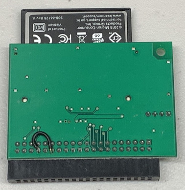

Here's my UDMA mod for my CF adapter-- Soldiering isn't as nice as yours, but it was adequate I guess.
108.59 KiB
153 views
I tested a Lexar Pro CF that supports UDMA 7 with a VT8235 onboard controller (AK39n) and a Matrox PCI ATA133 card.
The CF now negotiates UDMA5 instead of UDMA2, which is a boost. Thanks again for your help.

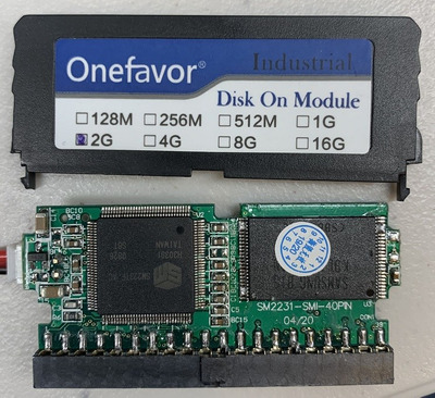

This guy is the next target. Has the exact same layout as the Leidisk, and they have the same controller chip as the hyper disk. Postest this picture to show what the flip side of the DOM looks like.
