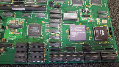

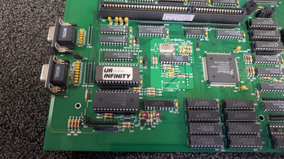

I've recently aquired and cleaned up a 386 machine, that has a very unknown motherboard in it. Yet it has lot's of jumpers, cache, etc, that could be modified.
I've tried to google it through multiple keywords, but unfortunately my skills have not been enough. Maybe one of you, guys, can help me identify that board with jumper settings and everything?

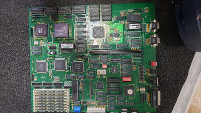

So continuing my investigation, i've noticed that those 2 chips are getting somewhat hot.
I've not let it run long enough to go burning (if they would), so i can not confirm if it goes hotter than one could touch. But they are very measurably hotter than any other chip on the board.
If i'm correct, the bigger one is super io controller chip on board: UMC UM82C862F.
The smaller chip is: Motorola MC1489P
Maybe this thing is preventing the board to properly boot up? All the bios codes that debug card shows (43, 0c, 0d) are not really talking about any problems. Also the board is not completely dead as debug card shows activity in the form of those codes running through until eventually halting on 43.
Any suggestions i very much welcomed.
I'm considering desoldering the super io chip and see, if the board itself would boot then...

Reply 8 of 35, by rmay635703
GigAHerZ wrote on 2020-12-07, 15:03:
CMOS battery is replaced - it's a brand new one.
I've tried it with original 4x1MB parity ram and i also currently have it equipped with known working 4x1MB parity ram.
The board has a lot of jumpers/switches - if i would know, what every one of those would do...
Those jumpers and switches won’t be much help
Puzzling them out (can’t see traces very well)
Jp5 is the cmos reset
The rest control exactly what they are by
Jumpers by the cache provide cache config
Switch blocks setup serial I/o
The rear switches appear to be video/monitor settings.
There is one group of 4 by the edge that looks like a Pc speaker header.
You will need to troubleshoot the psu and the board and caps first, I didn’t notice a proper 33mhz signal source either but that doesn’t mean much
Also your cache banking is all jacked up, you are either missing chips or they are in the wrong sockets, if you can figure out how to disable cache and remove it that might help

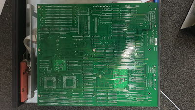

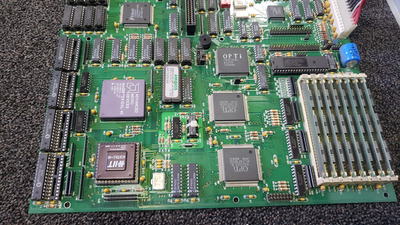

the design of this computer case is not regular
when you open the chassis you can see solder side of mainboard only. the component side is faced inward to the mounting plate and you can see most of the ics, jumpers etc through a small side gap and several holes only.
extraction of the motherboard is not so trivial. the case designers didn't thought on the repairs complexity at all. i will try to detach the board and make several pictures for you tomorrow. wish me luck not to kill the working system.
Reply 14 of 35, by Cbb

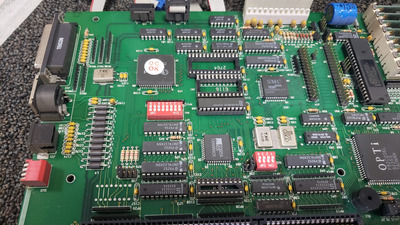

Here we go
Reply 15 of 35, by GigAHerZ
Thank you so much, Cbb!
Unfortunately, it seems to be a slightly different board, as it's layout is different.
Yet, still, thank you for taking this time for me!
Reply 16 of 35, by Cbb

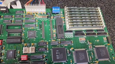

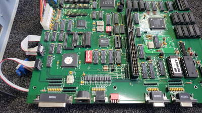

and 3 more pics
Reply 17 of 35, by Cbb
GigAHerZ, you're always welcome!
yep, the KB connector on your keyboard is definely in the other end of the PCB.
What's the print in the corner on the solder side of your PCB?

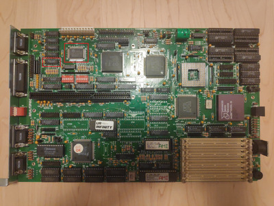

Reply 19 of 35, by evasive
I have added both boards to Ultimate Retro, maybe someone recognizes them and will add info.
https://www.ultimateretro.net/motherboards/6889
https://www.ultimateretro.net/motherboards/6890
