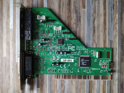

I have a FM801-AU, I bought it as it said it was compatible with SoftMPU and I have seen good things on this Forum regarding it.
But I can't get it to communicate over the Gameport. I am using a Raspberry Pi and Pi MT-32. As soon as I turn on the PC I get a 'Break Error' displayed.
Everything works great with my Yamaha 724 card, so I know my game etc is ok. So what settings are people using? Does the FM801 Gameport to MIDI have a special pinout?

Is it a real FM801-AU card? Pics of the card please.
Gameport MIDI pinout should be standard.

cyclone3d wrote on 2020-12-04, 07:56:
Here is the card.
