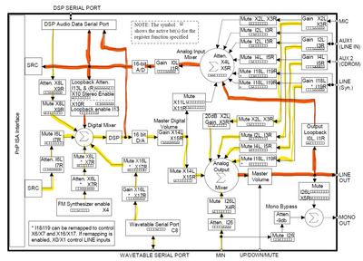

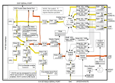

you can find nice info about CS4237 in this ftp://ftp.alsa-project.org/pub/manuals/cirrus/4237b.pdf. For outputting SPDIF this can be done:
Orange = output , Yellow = Input
the good way
247.36 KiB
1556 views
And the not so good way
257.49 KiB
1556 views
They go to the DSP Audio data SP. 2nd option can cause a lot of noise because it goes from the analogue mixer, so it outputs all the noise, you can do it in windows. Also things depend on SPDIF receiver, maybe yours is too sensitive. Also Malibu lacks of spdif buffer. But this shouldn't be an issue. At least it's not with my receivers.

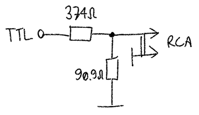

I would simply get a suitable bracket or make my own. You only need one 374ohm resistor and one 90.9ohm resistor in addition to wires and connectors.
Maybe I am just being dumb but I cant find the referred image.. An image of the bracket or schematic would be nice so I can build one myself..

That image is right here...
Anyway :

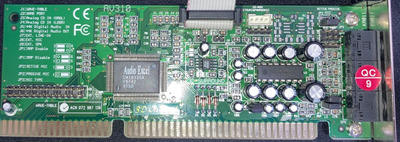

I have a "AV310" branded card which has the CMI8330A with supposed "3D On board"
I note it's not "on chip" as per your description but this seems like an odd choice.. (possibly the C rev was to save money??)
This card was an unexpected find in a Pentium 2 desktop I recently acquired and the card works great in a 386SX with DOS.
I have no idea how the 3D compares to the "C" revision chip but if anyone's got one and wants me to load a game and capture the output I'd be happy to.

@4xtx wrote about card with "8330A" chip and "3D Sound on Board" label. My guess that they (at C-Media) didn't remark a chip to "8330A/3D" but it is maybe a revised inside.
Anyway :DirtyTTLcoax.png
It should have a pulse transformer to take care of grounding issues, or you can use toslink to give you optical isolation. SPDIF spec has little to no DC bias. Loaded voltage is fine at ~0.6V pp, but open circuit voltage will also be out of spec. A simple voltage follower as a buffer takes care of that, although make sure the op-amp meets spec for rise time.

Hence the "dirty" in the filename 🤣. Ideally there's the transformer as I mentioned several posts before, then it will be proper and without ground loop issues etc.
I have used these parts successfully for this task :
https://no.mouser.com/ProductDetail/710-750082154
https://no.mouser.com/ProductDetail/810-ATB3225-75034CT
https://no.mouser.com/ProductDetail/673-TM8116NL
