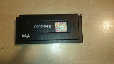

How do you disassemble this package?
I have a badly damaged Deschutes 266 with a metal part separated from the CPU core.
The metal heatsink side has 8 pins but nothing on the other plastic side but the logo.
I can't find a video where someone takes it apart without breaking the plastic as well.
Is it possible at all?

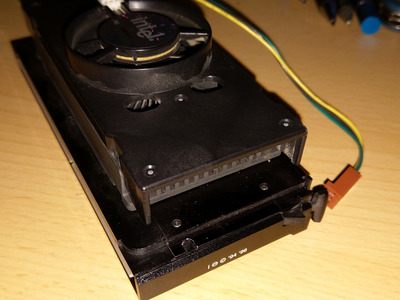

No idea. My 450 has a completely different kind of cooler. Yours seems to be the same as the one on my Klamath-266
1.09 MiB
888 views
Klamath-266
But to me it seems as if it was riveted. I don't see any obvious way to disassemble the cooler. I never tried to take the cooler off.
I have some hazy memories about reading somewhere that some slot-1 coolers were non-removable.
If it is riveted than probably all you can do is very cerefully drill the rivets out, but you have to have a steady hand, PCBs are soft.

It's not rivets, it's pins that can be pressed out with enough force. I can't remember how I stripped slot 1 processors like that 15 years ago, but it can be done. You have to be careful not to damage the circuit board though, it's not a simple task.

Yep ! They are press in pins. I used a Drill press with a nail (cut head and point off) and using wood blocks under the cpu forceably cranked the handle to push the pins out. It only comes out one way and almost screwed things up. Was a long time ago....
Added: and NO the drill was not turned on and you have to pop off the plastic front cover which is a biatch....

Okay, Mr. 266 stays as is because I'm not going to break it apart with force. I tried removing the thin plastic part under the metal part and couldn't even do that so I figured that I'd just brick the CPU and accomplish nothing. It works by the way and since it doesn't even dissipate that much heat anyway I just taped the loose part with a black tape. Not the nicest collector's piece but it's functional. I'll buy another one when it turns up.
Not the most user-friendly design but at least no legs to bend or break.

Vogons member Robert B has done it with a couple of Slot A's wich are identical to PII:

Thanks but watching that was enough. I don't have the nerves to do it. 😁
