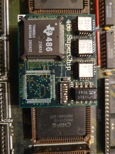

Does anyone have the DIP switch settings for these Evergreen 486 SuperChips? They allow you to use a Cyrix 486SLC on a 286. Thanks.
EDIT: Found them. Attached in pdf here:
Evergreen_486_SuperChip_DIP_Switches.pdf
634.73 KiB
73 downloads
604.73 KiB
2733 views
EDIT2: in text as well
SW1
ON = Double CPU speed using a 2x multiplier on the Evergreen interposer (not on the CPU)
OFF = Do not use Evergreen's 2x multiplier, meaning that it uses 1x
SW2
ON = Set for AST, Sperry, Unisys, etc. Used to obtain compatibility in systems having a slightly proprietary architecture
OFF = Set for IBM, Compaq, etc.
SW3
ON = Set SuperChip to match a system with a 16 MHz system clock
OFF = Not 16 MHz system
SW4
ON = Set SuperChip to match a system with a 12 MHz system clock
OFF = Not 12 MHz system
SW5
ON = Set SuperChip to match a system with a 10 MHz system clock
Off = Not 10 MHz system
SW6
ON = Set SuperChip to match a system with a 8 MHz system clock
OFF = Not 8 MHz system
SW7
ON = Set SuperChip to match a system with a 6 MHz system clock
OFF = Not a 6 MHz system
SW8
Always ON factory setting.

Am I the only one who owns one of these? If you have one, could you at least share a photo of yours so I can see what the DIP switch settings are?

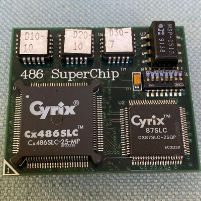

You might be the only one here with one. Here is a picture of one with CX486slc + 87slc-25, you can see the switch positions...probably already saw it...
https://wiki.preterhuman.net/Evergreen_Techno … 6superchip1.jpg

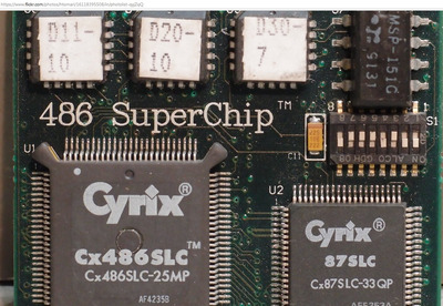

here is another picture of the 486 superchip with 87slc-33 and it's DIP settings

Oh? I guess I can pay off my mortgage sooner than I thought!

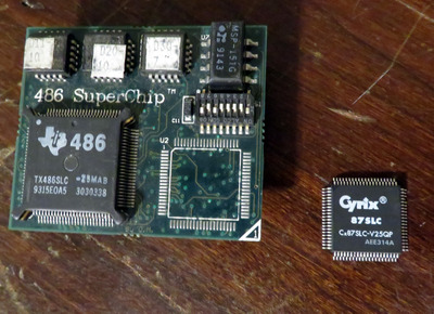

Thank you. I hadn't seen that second photo. It is very helpful. The second photo has the same PAL revision stickers that my unit has.
So from the 3 photos shown in this thread, DIP 6 & 2 are likely related to the FPU as, both your 1st and 2nd photo agree on these, that is 2:ON, 6:OFF. The uncertainly is with DIP 4 and 5. Your 2nd photo shows 4:ON, 5:OFF; while your first photo shows 4:OFF, 5:ON. On my unit without FPU, 4 and 5 are both OFF.
Why would these two units be in disagreement? Is it because the revision numbers on the PALs are different, or is there more than one way to turn on the FPU with different requirements?

Ok agree ! I looked over the dips too and figured that 1, 2, 3, 6, 7, 8 are same with either FPU and same CPU. So 4 & 5 could be Sync / Async mode and/or FPU speed setting.
Possible because of diff PALS but then they would have to have made diff docs for each revision (highly possible !). Also possible 6 is for CX or TX though technically the same maybe a slight variant ???
Attached a text file with the 1992 announcement of your Evergreen from a monthly tech bulletin and my quick similarity in dip settings... nothin special but the price of $499 w/FPU on release is interesting

I was planning on desoldering the Cyrix/TI 486SLC with some Chip Quick (have had it sitting in a bit for over 25 years now and never used it!) and replacing it with a Ti 486SXLC2-50. Hence I was hoping to figure out what the rest of those DIP switches do. Perhaps some of them relate to the SXLC variant, its cache size, cache invalidation and its multiplier. Evergreen certainly made upgrade modules based on the Ti 486SXL2-50/66, so it is possible that some of the DIP switches on the 486 SuperChip were for an SXLC option.
Horun, could be, but I think the Intel i387 FPU was the only 387 FPU which could do async mode, and as both of the photos show a Cyrix FPU, I'd expect the sync/async setting to be the same. Both have the same FPU speed as well.
My best guess is that some of the switches turn are to:
a) enable L1 cache
b) enable L1 cache, but no cache for FPU
c) disable L1 cache
Horun, is that table yours, or you found it on the web?
The DIP switch settings for 486 Superchip for 286 from pictures posted (No Guarentee they are proper or I got it right):
All pictures included a TX486SLC-25 or CX486SLC-25, the FPU are all CX87SLC
DIP NO FPU 25Mhz FPU 33Mhz FPU Common w/FPU Common for all
1 ON ON ON * *
2 OFF ON ON *
3 OFF OFF OFF * *
4 OFF OFF ON
5 OFF ON OFF
6 ON OFF OFF *
7 OFF OFF OFF * *
8 ON ON ON * *
So the difference between 1st and 2nd photo you posted are for 25 MHz vs. 33 MHz FPUs? Allowing for a faster FPU, wasn't this for Intel FPUs only?

Yes I made that table from the pics, could be wrong but think it is ok.
According to ChipDB the 87slc-25 is 25mhz and 87slc-33 is 33mhz.
http://www.chipdb.org/img-cyrix-cx87slc-33-qp-6536.htm
http://www.chipdb.org/img-cyrix-cx87slc-v25qp-447.htm
The only Cyrix cx87 datasheet found (so far) is for 87slc-25

I'm not in this for the money. I'll be replacing the CPU when COVID is over. I'll also be soldering on that FPU. These may have even come with an SXLC2 -40 or -50 at some point.

Horun, well I'm pretty sure you couldn't run these Cyrix FPU's async, so to get 33 Mhz out of the FPU, the CPU would also be running at 33 MHz, meaning it would be upgrading a Harris 16 MHz 286? User Anonymous Coward knows a lot more about 286 upgrades than I do, perhaps he will chime in.

But the cpu on that one with 33Mhz FPU is still a 25Mhz version CPU. Another thought is that someone added the 33Mhz FPU to a non-fpu interposer because they had one.
Or maybe Evergreen just got a great price on them and said 'sure send them' 😀

I think it was a condition of availability, price, or both. I've seen 40 MHz FPUs on many 386 interposers which only run the FSB at 25 MHz. But your point is certainly valid about the DIP switch settings being different with different FPUs installed. However, the PAL versions are also different. Need more information!
