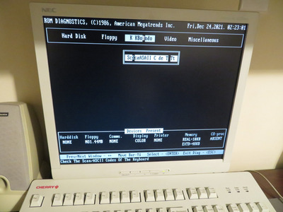

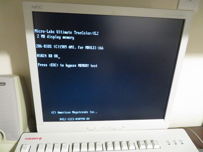

Do you specifically recall testing your Micro-Labs ET4000/w32i on this here VLSI 286 board? I'd be surprised if we had different outcomes. I've attached a photo of my ET4000/w32i card:

I see this screen on initial power on:
391.24 KiB

Shortly after RAM checks OK, it hangs on this screen (notice the garbled characters):
372.04 KiB
952 views

Try re-testing the Tseng card with the 0WS jumper set to 'Disabled' (bottom two pins). Beneficial as 0WS mode is, it doesn't always work on all old motherboards, and sometimes causes weirdness like that to occur.

Eep386, I had already tested with 0 ws and no 0 ws, and with IRQ enabled and IRQ disabled. I also tried without any other cards installed. The outcomes were the same on my VLSI200 286 system. On the other hand, the Microlabs card worked in all 386 boards I tested it on, so...
I'm still waiting on a BIOS from megatronUK from his VLSI board, maybe that will help matters. Unfortunately, though, the Micro-Labs card only supports high resolution (I think 1024x, or 1280x, I forget which) and high colour in interlaced mode, which my LCD doesn't support. I've been told that some cards have better RAMDAC's which can do 60 Hz with the 2 MB, but not mine.

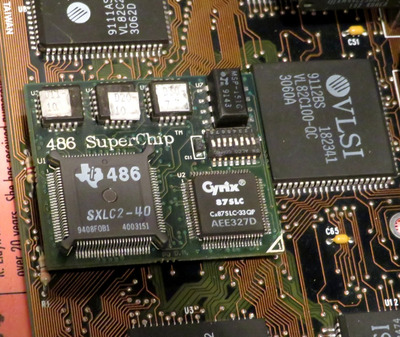

The 5V FPU and SXLC arrived and I soldered them onto the Evergreen 486 SuperChip. The good news is that the chips are functional, that is, not DOA; the bad news is that the 5V SXLC2-40 suffered the same fate as the 3.6V SXLC2-50. Trying to use the L1 cache of the SXLC CPU causes the system to hang. So, I'm guessing there is some aspect of the Evergreen's onboard logic that is interfering with proper operation of an SXLC.
This leaves the SLC 25/50 or SLC 33 as the fastest options for this interposer. I was informed, unfortunately, that the SLC 25/50 is permanently stuck on 2x mode. This will greatly limit the front-side bus and performance. Does anybody have any data or anecdotal evidence of how far the Cyrix SLC 25/50 (not IBM varient) and Cyrix SLC 33 will overclock reliably? I will have the following scenarios to test once the SLC 25/50 chip arrives.

Reply 116 of 174, by pshipkov
Disappointing.
These cpu upgrade modules are flaky pain in the a.
So, you are confident that no combination of these switches unblocks the L1 cache ?
As mentioned before I am able to run sxl2-50 at up to 70mhz on these vlsi mobos, but the practical limit is around 64mhz.
Not sure this is a valid ref point for sxlc chips.
BTW, did you try to plug the memory card, even unpopulated to see if it ticks at all ?
retro bits and bytes
Reply 117 of 174, by Anonymous Coward
The TI and Cyrix 486SLC chips should be identical except for the branding. Unless they were manufactured after 1993, I wouldn't expect them to overclock very well. Unless your your chip is exceptional, 40MHz is probably the best you'll be able to pull off.
Reply 118 of 174, by feipoa
I tried several combinations of DIP switch settings when I had the 3.6 V SXLC2 installed previously but didn't get it working properly. I didn't try all possible combinations as there are too many.
