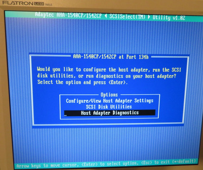

Reply 160 of 174, by feipoa
Thank you!
Running:
DEBUG
g=dc00:7
opens the SCSI BIOS configuration utility, the same one as CTRL-A at boot time. However, it looks as if the DMA test routine has been built into this CTRL-A BIOS boot menu already. Perhaps it isn't in the *B variants of the 154X card? Either I didn't notice it previously, or I simply thought it was the common "verify media and remap sectors" feature.
HOWEVER, the benefit of running it from debug is that I can have all the Cyrix CPU registers setup first and thus determine if they are interefering with DMA transfers.
278.84 KiB
1073 views
250.45 KiB
1073 views

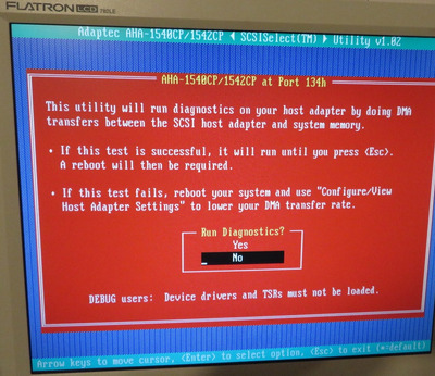

Reply 161 of 174, by feipoa
Hmm.... even with a [safe] DMA rate of 5.0 MB/s, if I run the DMA test after I've booted the system into DOS, I get
BUFFER MISCOMPARE!!! PHYSICAL ADDRESS: 020036h  OFFSET: 00h
Can himem not be loaded?
If I run the test from CTRL-A at boot time, 5.0 MB/s and 6.7 MB/s pass the test. It fill fail at 8.0 MB/s.
Reply 162 of 174, by maxtherabbit
feipoa wrote on 2022-02-28, 13:28:
Hmm.... even with a [safe] DMA rate of 5.0 MB/s, if I run the DMA test after I've booted the system into DOS, I get […]
The test needs to be run with nothing loaded. Since you have it built in to the SCSISelect I would suggest just running it in the pre-DOS environment
1542B cards do not have SCSISelect FYI
Reply 163 of 174, by feipoa
maxtherabbit wrote on 2022-02-28, 14:17:
In that case, 6.7 MB/s is max for SLC2. I'll see what my SXL2/ULSI2 can do, which has the same scsi card. EDIT: Best the SXL2-66 could do is 5.7 MB/s.
Reply 164 of 174, by feipoa
Small update - just because the SCSI BIOS diagnostic utility passes a particular DMA speed, doesn't mean it is stable in DOS and Windows.
I was running it at 6.7 MB/s, thinking it was stable, but HDD access will eventually hang up. I've put it back to 5.0 MB/s.
