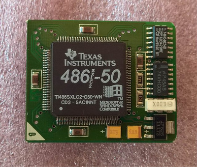

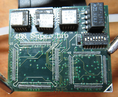

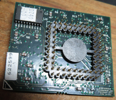

I've finished the surgery on the SuperChip. I've put the TI SLC back on. Hopefully it still works. Also, I'm attaching a photo of the bottom of the Evergreen 486 SuperChip for anyone who is looking for it.
The surgery went OK. There was only one solder bridge, not coincidentally at the point of the thickest paste blob. Also, I learned best to get the solder paste right in the middle of the pads - there was some no-connects at the point you see the paste line deviate from centre on the SLC chip. All easily fixable with a standard iron.

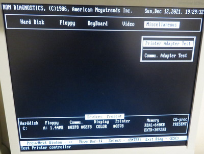

Reply 67 of 174, by feipoa

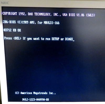

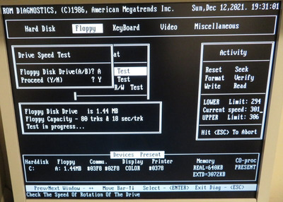

Attached are a few more images in case I've missed something concerning the floppy issue.
Screen at power-on:
185.99 KiB
738 views

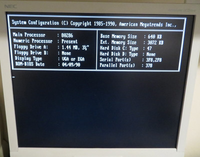

This is the screen it hangs on when trying to boot from a floppy and a 286 CPU is installed:
87.29 KiB
738 views

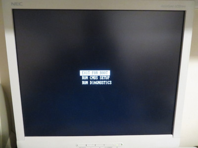

This is the screen visible when you press DEL to enter BIOS:
50.35 KiB
738 views

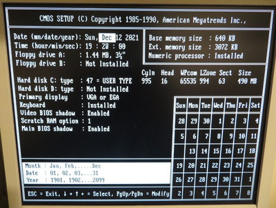

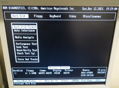

These are the only BIOS options:
137.8 KiB
738 views

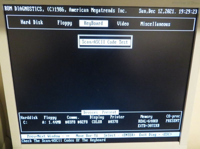

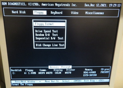

If I enter diagnostic mode, I can run the floppy diagnostic and it passes:
120.11 KiB
738 views

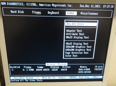

In case anyone is interested, here are all the BIOS diagnostic options:
95.61 KiB
737 views
90.23 KiB
737 views
87.02 KiB
737 views
98.86 KiB
737 views
91.14 KiB
737 views

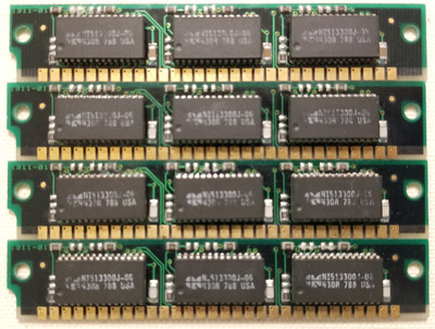

Reply 71 of 174, by pshipkov
How this board runs at 27.5MHz with 0 WS ?
Like this.
The post wraps the whole story.
Videos included as well.
Don't have oscilloscope, so no idea what the ISA bus frequency is, but perf is unique.
So it does something right there.
These boards are just solid and very fast. I am pretty sure they can do 30MHz at 0 WS if there is memory to withstand that.
So all the magic is in the memory.

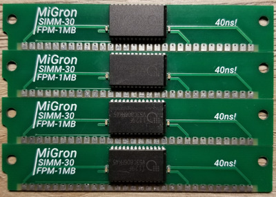

Tested a lot of SIMM modules, including some modern stuff like this 40ns set i bought from another Vogons member.
While it works fine at up to 25MHz 0 WS - no lights at 27.5MHz with it.

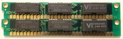

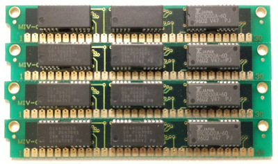

The best set is this VT one, but i have only 2 modules:
72.98 KiB
687 views
Along with it is this "USA" one. For the rig in the post i linked to i use 2 VT and 2 "USA" SIMMs. It is almost fully stable in a cold day without active ventilation:
168.19 KiB
687 views
Second best is this Viking Components set. Solid at up to 25MHz with 0-WS and no active ventilation, but a bit flaky at 27.5MHz:
132.26 KiB
687 views
181.52 KiB
687 views

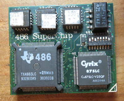

I tried the Gotek floppy emulator, but it too would not boot when a 286 CPU was installed. So, not sure how you got it booting.
The FPU appears functional on my SuperChip module, or at least Landmark Speed v2.0 outputs a benchmark result. I'm using Cx87SLC-v25QP for the FPU. These should be the 3 volt variants. Are they OK at 5 V without a heatsink?
It looks like I do not need to enable the FLUSH or BARB pin to benefit from L1 cache. Is this the case when external cache flushing circuitry is used? Enabling the FLUSH pin does not change the performance, but setting BARB reduces it by 20%.
I am able to clock the TX486SLC up to 33.3 Mhz. I'm not sure why I couldn't go above 25 Mhz previously - perhaps the 3-chip memory, or the SXLC was the issue. Taking it up to 33.33 MHz, I get a Landmark v2 score of 105.2 MHz ALU and 41.6 MHz FPU. This translates to a Landmark v6 score of 135.4 Mhz ALU and 36.5 MHz FPU.
Also, cachechk shows 25.1 MByte/s read for the L1 and 11.5 MByte/s for main memory read/write.

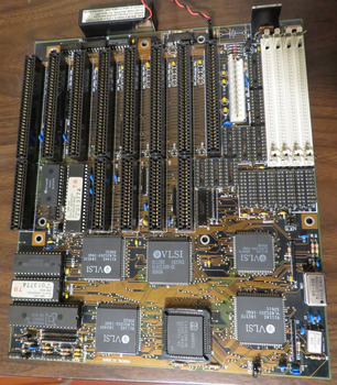

This is a VLSI 200 series chipset - have you verified the ROM shadow jumper is correctly set on the board?

If your FPU is 3V, then running it at 5V might not be a great idea.
The SXLC2 is also a 3V part. Some people on here run them at 5V without issue, but maybe you got one that just couldn't handle it.
Reply 75 of 174, by feipoa
The FPU doesn't seem to get very hot, but nonetheless, I've put on order a non-v variant with the 33 Mhz designation. I've also put on order some TX486SLC chips with the 33 MHz designation. Let's see how fast this little SuperChip can go.
Indeed, the SXLC may not like L1 enabled at 5 V. I'm not sure how others got around this. Were there PGA-68 or PLC-68 interposer modules with a VRM onboard?
Re: ROM Shadow - there's but one jumper with 'shadow' in the description and it is 'Shadow BIOS' via J8. I've tried it with and without J8 installed. There's an unspecified jumper, J1, but I've also tried with and without J1. Anonymous Coward had located this jumper page for me a few days ago, http://www.uncreativelabs.de/th99/m/U-Z/30595.htm
In case anyone else is trying to get a 486 SuperChip running with FPU, these are the DIP switch settings I'm using:
SW8 - on
SW7 - off
SW6 - off
SW5 - off
SW4 - on
SW3 - off
SW2 - on
SW1 - on
These are the settings found in a photo of another module online which had the FPU installed, however I suspect only SW2 is used to enable/disable the FPU.
Anonymous Coward wrote on 2021-12-13, 15:56:
Do you know the thread?

Here's some kind of upgrade module with an SXLC2-50 on it, which has an interposer. Any idea what this is called? Image is from archive.org.
Reply 78 of 174, by Anonymous Coward
They made these as upgrades for both 286 and 386 systems. If I had to guess, this is a clip on 386SX upgrade. It seems to lack enough glue logic to make it work on a 286.
These were made by all the major upgrade vendors. I'd have to compare with the one I have, but it looks an awful lot like my Improve Technologies Make-It-486.
