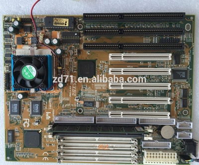

So I have a p55xb2 socket 7 motherboard with two sd ram slots and four simm ram slots.
I’ve previously been able to get 256mb into it and that’s about it.
What I understand is the chipset seems to only like 256mb
Obviously I could install 2 512mb sticks but those woupdn’t work and I have tried one with 16 chips per stick before and it did not.
My question is, if I install two sd sticks 256mb each with 16 chips each can I then install 4 128mb or 64mb simm sticks and end up with more than 256mb? Recognized? I know that when you install simms and dimms you sometimes get both to recognize but with the dimm being 1/4 the size.
I’m looking for any tricks to get above 256mb
I’m going to use a k6 III+ so my cachable limit is 4gb

256 MB is your maximum. https://stason.org/TULARC/pc/motherboards/Q/Q … ium-P55XB2.html

The memory controller in the 430TX chipset is limited to 256MB RAM maximum, there is no workaround for that .

Not quite.
Intel's official specs give it max 256MB with 64Mb chips. But... the memory controller is identical to the i440EX's and can take 128Mb chips too. So with two double-sided 256MB DIMMs, you can do 512MB.
You do need to be pretty specific with the DIMMs and chips: 16 chips with 16Mx8 structure. Fortunately, pretty much any 256MB PC100 DIMM will have this. With PC133 you need to look out for 8 chip (256Mb per chip) modules, or worse 16 chip 32Mx4 things.

Not quite.

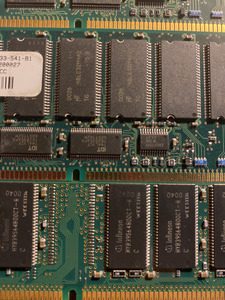

These are the sticks I have to play with so far.
All are chiped on both sides so assume double the chips that are visible.
I can get another double sided 256 if the ecc ones don’t work and the 256 plus the 128 works? Or is there a weird situation where 384 wouldn’t work as a test and 512 would?

The middle two are registered, they're not going to work on a non-server board. Desktop chipsets only eat unbuffered DIMMs. ECC or not is irrelevant.
Bottom one is iffy, for starters it's 128MB, and looking at the datasheets of those HYB39S64800CT-8 chips shows they can be configured either as 8Mx8 or 16Mx4. If the former, it will work, if the latter, it won't.
The top is the real deal - 16Mx8 chips, so 256MB usable by the i430TX.
Best case you can get 384MB with these DIMMs.

Sweet! When I get the board I’ll start playing with it.
Do you happen to have a twin to the 256 that I need?

I tried what I believe to be a 16 chip 512mb stick in this board 16 years ago and It did not work. I don’t remember if it was a no post or only showed 64 or 128mb. Or something like that. I want to say no post.
But I may be getting two 512s to try soon. It would be great if they worked but I don’t think they will
Sphere's PCB projects.
Reply 16 of 67, by Sphere478
I was thinking of ordering some 128mb simms for this also maybe some 64mb ones.
Anything I should look for? Anything that would stand a better chance of working?
Are we pretty much consigned to “using simms and dimms together” as not being a tool for cramming more ram in there?
Reply 17 of 67, by debs3759
The link I posted shows all your options.
You can use banks 1+2, 1+4, 2+3 or 2+4 together, but not 1+3 or 2+4. So 1+2 or 3+4 is your best bet, depending which is faster. And 256 MB total is your limit.

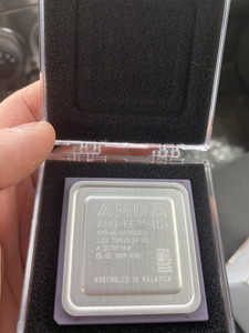

I was sure that 256 was the limit, but I decided to try for myself. Starting with a 256 PC133 in one slot that I've been using for some time, trying any of the other 256 meg sticks of SDRAM I have in slot 2 would just cause it to beep without posting. But there were a couple of different 128s that it recognized and would POST with, recognizing 384 (393216)! But in both cases, it will only boot up in Safe Mode, and I've been content with the performance of this machine with 256 megabytes so that's the end of the experiment for me.
Asus TXP4 with a K6-3+.
Reply 19 of 67, by Sphere478
Repo Man11 wrote on 2021-01-20, 03:35:
Holy crap! It worked!
Any ideas about why safe mode was required? Can you post pics, details of the sticks that worked for you and did not?
Sounds like there is definitely hope!
What cpu are you using? Also is motherboard cache enabled?
