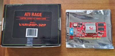

First post, by akm513

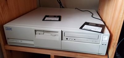

About a year and a half ago I picked up an old IBM PC 340 at a recycling center. It was a mess and was in pieces, but I cleaned it up and put it back together and it has been working well. I've also upgraded and added some things to it - added more memory (80 MB now), a new CPU (P166), a CF adapter, and now I've been trying to upgrade the video.
file.php?mode=view&id=102752
I found an ATI Rage 128 Pro and installed it, but the machine will not post with that card installed. It's the PCI based version for PC. There's a jumper on the motherboard to enable or disable on board VGA, but that doesn't seem to have any affect on this issue. I've also put this card in an XP machine - it booted into Windows and identified itself as the AGP variant (it isn't).
file.php?mode=view&id=102753
I've scoured IBM documentation and other forums and have come up empty handed. Is there something simple I am missing?

(also ooooh that PC looks nice it's so clean and preeety)

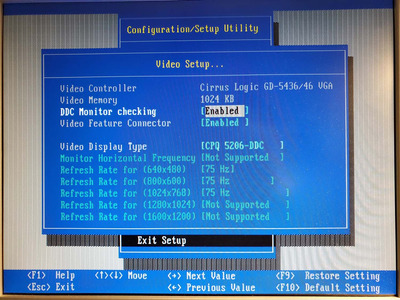

Reply 5 of 21, by akm513
athlon-power wrote on 2021-02-11, 16:45:
Thanks! I spent a lot of time cleaning it up. I'm pretty happy with the way it came out.
It's a long shot, but some BIOSes screech irrationally when you don't do exactly what they want. It's possible that there's a BIOS setting for changing the primary video adapter- you might be able to remove that card, enable integrated graphics, go in and make the default video adapter go to the PCI slots, and put the card back in and disable the integrated graphics.
Not sure if you are referring to screeching as beeps - there is no beep or tone when the card is installed. It's just a blank screen with a flashing cursor. When I remove the card, the system returns to normal. The PC BIOS has just two video settings that I can see - DDC Monitor Checking (when enabled it autopopulates the fields at the bottom) and Video Feature Connector - I've tried this in both enabled and disabled modes, but still nothing.
file.php?mode=view&id=102757
athlon-power wrote on 2021-02-11, 16:57:
[EDIT]
I misread, it says that in Windows. Does it initialize the video card before the BIOS when it boots up in the XP machine? Should be something like a brief screen that says "RAGE 128 VGA BIOS" and lists the amount of video memory and something along the lines of "COPYRIGHT -insert year- ATI". I've not seen many Rage 128 initialization screens, but I've seen plenty of others (3DLabs, nVidia, S3, etc.) and they usually follow that formula.
When in the XP machine, the PC's BIOS is the first screen that appears. It's just a black screen before that (the monitor is awake and displaying a black screen).

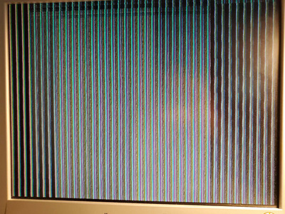

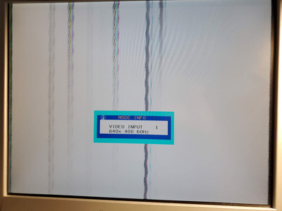

Reply 19 of 21, by akm513
The TNT2 card arrived today. I popped it in my machine and got yet another problem with various colored lines. Interestingly, with this card installed, it seems to disable the on board video adapter - the monitor won't even wake up when the VGA is plugged in.
file.php?mode=view&id=103810
file.php?mode=view&id=103811
As with all of the other cards, once I remove the card from the system, all normal functionality returns.
I'm thinking now that this system just isn't able to accept an upgraded graphics solution...
