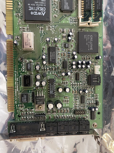

So I picked up a CT3670 for fairly cheap, and I thought it was fine, but after testing it with Diagnose and Duke Nukem 3D, I realized I wasn't getting any sound out of the right channel.
And I mean the right channel. I can still hear sound that is intended for the left channel or center channelcome out of it. But specifically the right channel is not outputting anything. Which makes me think there's either a chip problem or capacitor somewhere based on the help in previous threads on this forum.
I do not have an oscilloscope, so it might be difficult for me to trace the problem. Does anyone have any ideas on what to start or replace? I wouldn't have any problem replacing all the capacitors if that's the issue, as they're all radial, through-hole.

Would you mind uploading quality pictures of your card so we can look for obvious problems?
No sound whatsoever on one channel could also be a problem with the audio jack or the cable you're using.
Did you make sure the rest of the signal path is ok i.e. by playing audio from another source?

Sure. Let me take a few photos. There was a little corrosion on part of the board, but I cleaned it up to copper trace and it appears to still be good.
And yes, I’ve tried the line in and speaker out. Both are missing that right channel. And I’ve tried multiple speakers.

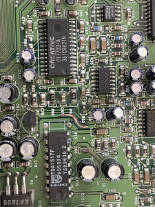

Reply 4 of 21, by RoadWarriorB

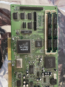

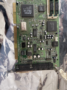

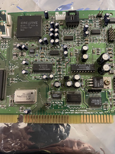

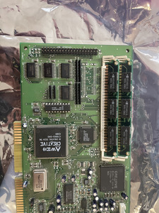

Pictures attached. As I mentioned, there was a little corrosion over a trace, but I cleaned it up to the copper to check, and it’s fine as far as I can see.
Reply 5 of 21, by Doornkaat
Thanks for the pictures!👍

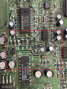

The whole area I have marked looks pretty nasty to me and I think you should try cleaning it up some more and check for countnuity on the vias.

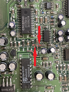

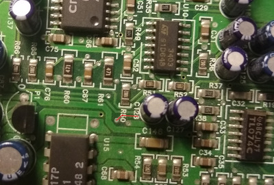

One trace that looks particurlarly suspicious to me is marked in the second image I attached (taken from my working card). It is the via right next to R50. I believe this is one of the stereo channels and I'm not certain the trace is still connected to the via.
582.47 KiB
401 views
Could you check this on your card?

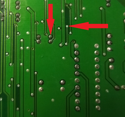

355.82 KiB
401 views
Lastly are those vias/connections good? They're on the same channel as as far as I can tell. Scrape away some of the crusty corrosion and see wether there's continuity from the nearby pad to the other side on the back of the pcb. Basically check wether all the red dots that are connected with red lines in the picture are still electrically connected. (I hope you get what I'm saying, my wording is terrible right now I believe.)

Cleaned it up. No broken connections anywhere. Everything posting low ohm resistance on the places you had me measure.

Okay, finally got to testing it. Still no right channel audio out of the right side. Sometimes the center channel can be heard bleeding over a little, but that's it. I even moved it to another machine and am getting the same results.
So I'm thinking bad chip or bad cap somewhere. What would be the easiest to start with? Any way to test?

It looks like several capacitors have leaked on the card so a recap is in order, and that should fix all the problems the card is exhibiting.

Just recapped the entire board with nichicons audio grade, and still not outputting on right channel.

I have another card that's exactly the same model, and it isn't having any of the same issues. I've also tried this problematic card in two computers, both showing the same right channel issue.

C416 passes right channel to the speaker amp, it looks pretty crusty and probably is the culprit. You can also check L5 for continuity as it also is in line with right channel to speaker output.
The capacitor has 0.33µF capacitance, voltage rating should be anything higher than 12V. I'm not sure what the package code is though, 1206 perhaps.
You can also solder a normal e-cap instead of it, with + side toward the amplifier chip, it will also improve bass response at the normal 1...10µF capacitance.

C416? They don't go that high. Do you mind circling your suggestions it on one of the pictures I posted? This is my first time fixing a sound card.
