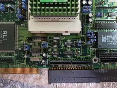

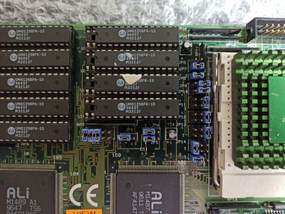

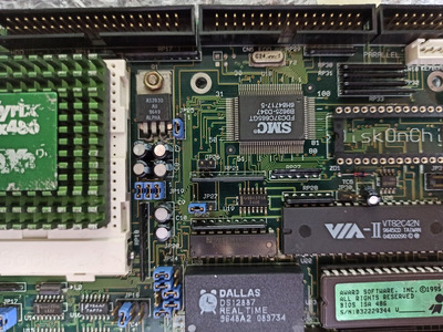

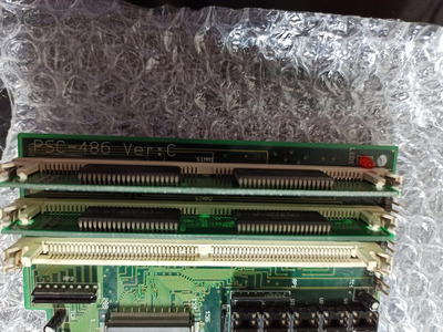

Hi,
Recently i bought PSC-486 board about 7$ with cpu and ram.I found out power pins on connector 11 via a multimeter.
Hooked isa graphics card to it with my diy isa adapter and powered on board, it just works fine but i want to test it with other socket 3 cpu's and play it for just fun.I have searched online for cpu speed and voltage jumper settings and manual for this board but no information available sadly.
Could anyone point me right direction?I have basic electronics skills but cannot identify which jumper is which.
Attached photos to post.
Thanks in advance.

Reply 2 of 12, by Deksor
The POST string is "07/18/96-ALI-1487/89-2A4KDD34C-00" if that can help anyone ... I also read "KU32C-01" on the POST screen.
I couldn't find anything about this card even with the POST string. No manufacturer, no manual, no nothing ...
All the informations I could find were the infos you posted and auction sites.
The best you can do is to figure out the jumpers by yourself I think.
Can you dump its bios so I can upload it to UH19 ? (see my signature). If you make any progress, please report so this board gets better documentation 😀

Reply 3 of 12, by whitepawn
Many thanks for your reply.I also searched POST sting but as you said i could only find: https://www.wimsbios.com/chipset/2A4KD.jsp simililar post string.((2A4KD)Ali chipsetand (D3) Digicom?)
How can i identify jumper settings with a multimeter?Is there any guide for this?
I have tried to dump with "UniFlash v2.00.SPI.RC03" but it cannot identify bios chip sadly.Are there any other programs for it that i can try?
If helps i can remove chip and try to read it with eeprom reader (i dont have reader but i can find someone who has).
I will update post if i found something useful.
