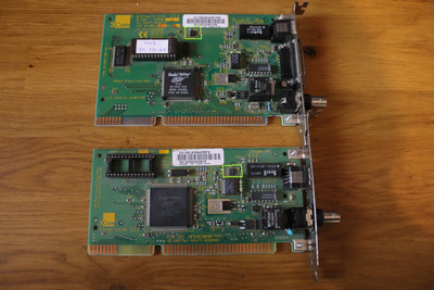

Reply 6 of 10, by megatron-uk
ElBrunzy wrote on 2021-03-02, 03:27:
I really appreciated your help too dionb. I forgot about that old procedure that you needed to configure the ISA NIC using a software in dos, I wonder how it's stored on the card. There is no battery or eeprom, that's why I though it was reset at boot and configured via pnp bios.
Pretty sure all models of the 3C509B have a small eeprom on board (it's not the rom in the DIP28 socket if yours has one - that's the boot rom) to save the settings made with the DOS setup tool.
Edit: Yep, just checked, both my 3C509B-Combo and 3C509B-TP have a tiny 8-pin 93c46 serial eeprom on board.
93c46 eeproms highlighted in yellow

Reply 7 of 10, by ElBrunzy
Oh so this is a eeprom ? Ok I stand corrected, thanks for the info megatron-uk. Guess I could plug the card on an 486 board and change it's config then as the crash is probably due to too fast cpu. But the documentation say there is no win2000 driver from 3com and microsoft dont ship any with the OS (using nt4 one return an error message as the inf format is unexpected, maybe this is fixable).
Then I guess it's safe to say that the UMC UM9007 use the atmel 93C46 too. Since this one nearly worked but used port 300 (reserved for DreamBlaster) I could had hack it out using an eeprom programmer since this one is socketed...
