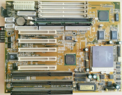

I finally got this build far enough along that I'm wanting to try to do some more overclocking to it
I want to try to get the fsb to 83 or more mhz but right now I'm stuck at 75mhz
motherboard: p55xb2
(random pic from internet, I'm using a k6 III+ cpu)

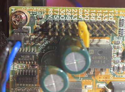

this next picture shows the jumper setting that gives 2x multiplier and 75mhz fsb
It has a weird way of setting the processor ratio and bus speed all on one jumper group:
781.65 KiB
1226 views

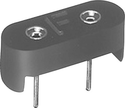

so I had another idea.. what if I buy a socket for the quartz and buy an assortment of crystals? has anyone ever done that?
will the computer still think it's going at the same speed or can it tell by comparing to the rtc that the bus is going faster when the quartz is changed?
and what speed quarts crystals should I get?

When you change the 14MHz crystal you will cause some essential things such as system timer to speed up, which will break a lot of software. The very least you must make sure that all the 14MHz outputs remain what they are. Other things wouldn't be a problem as long as the PLL itself will be able to handle the higher clock input which it might not. Datasheet will tell what range there is that is guaranteed to work.

According to the datasheet, this will screw up a ton of things. Your ISA bus clock, FDD clock, and if the motherboard has USB (looks like it doesn't) it will break USB as it requires a 48MHz clock.
In short, changing the crystal is a bad idea.

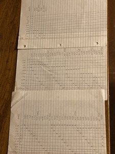

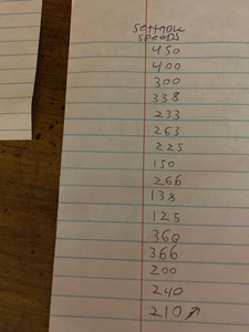

Reply 10 of 18, by Sphere478

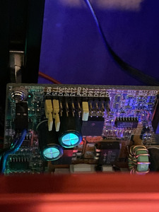

I’ve been doing tests on the jumpers.
1.17 MiB
1032 views
I’ve been able to set these speeds
1.63 MiB
1032 views
Here is the table:
1.86 MiB
1032 views
Some other speed settings were from doing this:
1.52 MiB
1014 views
Does it look like any of those speeds may be based on 83mhz?

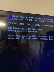

Proof of concept. Unfortunately.
I was able to achieve the as of yet unattainable 330 mhz setting by shorting f0 to f1 while jumper was set to c200 aka 450 75x6. The short creating the setting 55x6 330
This unfortunately confirms that my theories about how it’s set are correct and that the async settings including the 83mhz setting aren’t working for some reason.
Any ideas why async settings aren’t working on this clock gen?
