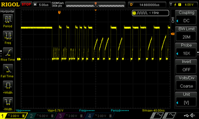

Further tracing shows a potential fault with the SIS 85C496 itself, a faulty octal buffer was discovered that buffers the DRAM address lines, including A11. I replaced the chip and verified with a DSO that things were now working, however, this is the signaling I am seeing coming from the A11 line now.
28.34 KiB
59 views
This is after reset for the first ~100ms during which time the BIOS is probing the RAM for it's capacity. It's pretty ugly (I call it a squawtooth signal 😜) and leads me to believe the output in the 85C496 is damaged.

I gave up on this board and used it as a parts board to repair the other one, swapping the northbridge over. Using the AWARD bios as I damaged the original AMIBIOS from this MB, I was able to run the system, not only does it work correctly, it detects ALL the ram properly! This confirms that the DRAM controller in the northbridge was faulty!
