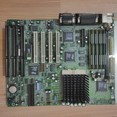

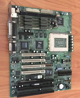

Reply 10 of 22, by Kotu Koylu
Deksor wrote on 2021-03-07, 11:50:
Can you upload a good photo of your board so we can add it to UH19 ? http://www.win3x.org/uh19/
Sorry for side-angle.
    156.46 KiB
    234 views
Reply 11 of 22, by Deksor
The angle isn't a problem (except in extreme situations), we can straighten it however the resolution is quite low 🙁
At least it gives us enough infos to add this board to UH19, but a better photo (even with an angle like this) is welcome !
alternative
Reply 12 of 22, by Kotu Koylu
Deksor wrote on 2021-03-08, 14:49:
Enough?
    1.54 MiB
    209 views
Reply 13 of 22, by Kotu Koylu
Pentium Pro 150-200mhz cpu support
60/66 Mhz fsb support
2-3-4 cpu clock ratio
4 x72 pin simm ram slot
1 5volt sdram slot
İntel fx chipset
4 pci 3 isa slot (1 isa/1pci shared)
Onboard 2 rs232 / 1 paralel port /2 usb port (usb mouse keyboard not supported)
2 ide /1 fdd connector
Onboard Creative Sound Blaster Vibra 16 CL sound chip (isa pnp)
Gameport
ESC key enters bios boot menu(cd/floppy/hdd)
Phoenix Bios
That is it 🙂👍
Reply 14 of 22, by Deksor
Thank you !
I have added the motherboard here http://www.win3x.org/uh19/motherboard/show/7644
Would you like to dump its bios using uniflash as well ?
alternative

Reply 17 of 22, by Deksor
I contacted evasive, according to him, the board is an Acer V60X. The acer brand is confirmed by the bios : in the readme file you can read "Acer" being mentioned. Also the acer V60N (baby AT motherboard) looks similar in the PCB color, components and connectors : http://www.win3x.org/uh19/motherboard/show/221
Unfortunately he has nothing else. Maybe Acer V60X rings a bell to someone here ?
