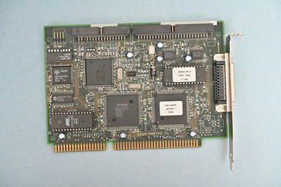

I attempted to upgrade BIOS and microcode on my Adaptec 1542CP and it did not end well. I attempted to flash this one to this card:
288.83 KiB
178 views
I was too lazy to reach for new chips and attempted to update original EEPROM chips 🙁 That was a stupid decision I know.
The new update did not work so I was about to flash it back.
At least I saved the original content. However, I can't flash them back for some reason. It fails to verify:

However, the Adapter BIOS doesn't show at boot when the card is in the PC. And also the checksum of .rom file read back doesn't match the originals I saved
If I use new chips I can flash it without --skip_verify. However, the BIOS doesn't work either.
Not sure if could be because I am using 512kBit SST27SF512 chips - originals were 256kBit AT27C256R).
Anyone has any idea how to debrick my controller? Or have a known working copy of BIOS files for this card?

When I'm using replacement EEPROMS larger than the original I edit the rom file to double the size and fill the empty space with a copy of the rom. Usually this works if the EEPROM is electrically compatible.
Reply 2 of 6, by maxtherabbit
You are telling the minipro to program a AT27C256R which is an OTP EPROM i.e. it cannot be erased after it is initially programmed.
OTP = "one time programmable" = you never should have tried reprogramming it to begin with. All you did was corrupt the code that was already on there.
You need to throw the 27C256Rs away, and use the flash - remember to change the command line to reflect the IC you are actually using so the programmer will know it is flash memory and do a proper erase before write. Might as well use the newer binary images too, the only reason they didn't work initially was because you were trying to write them to an unerased EPROM. Also duplicate them like the previous poster mentioned

What is the best way how to pad the ROM to fit larger chip? Just concatenate 32768 empty bytes to the end of the file? Like this?
dd if=/dev/zero of=zerobytes.rom count=32768 bs=1
cat zerobytes.rom >> adaptec-1542CP-rom2.rom

no, duplicate the existing image
on windows it would be:
copy /b adaptec-1542CP-rom2.rom+adaptec-1542CP-rom2.rom outputfilename.bin

Got it working (with 512kBit EEPROMS and duplicated contents) thanks! Lesson learned. At least I am glad I saved the original ROMs.
Anyway, if anyone has a BIOS version newer than 1.02 (that supports 4GB disks, please share it)
