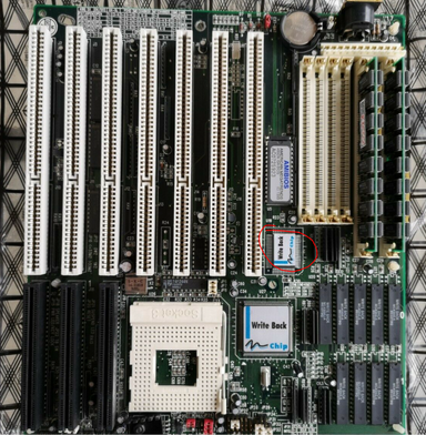

Reply 4 of 21, by original_meusli
Below is a picture of the MB from the Ebay listing (at work so cant get a new pic). I can't see the OPTi chip anywhere, is the write back chip circled the alternative?
    1.41 MiB
    179 views
Reply 5 of 21, by weedeewee
That looks more like one of my crappy pcchips m912 boards, actually identical, even has the same version number in the same corner, except for the stickers on the chips.
I've measured on mine, even pulled the label off and, surprise, no chipid engraved, and that chip is different from the opti 82C602.
Neither pin 5 nor 55 are connected to the battery. So it must be another pin. I'll check later.
Reply 7 of 21, by Deksor
It's indeed a PCChips m912 rev 1.7 to be exact.
http://www.win3x.org/uh19/motherboard/show/573
It has actually a UMC chipset. Yours have fake cache though (and yes the bios reports L2 cache but it lies. Run a cache benchmark and you'll see the truth)
If you're motivated enough, you can get rid of the fake cache chips and install real ones though.
Also it's using a standard cr2032 battery 😀

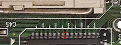

Reply 16 of 21, by weedeewee
Should measure about 2.5V between ground and that pin
apparently there's an extra diode that drops the voltage.
if the voltage isn't there, check R51 & D7 (near the battery) should measure 3V and 2.5V between ground
the same location on the v1.4 board.

Reply 17 of 21, by original_meusli
weedeewee wrote on 2021-03-09, 16:17:
Should measure about 2.5V between ground and that pin apparently there's an extra diode that drops the voltage. if the voltage […]
I'll try that tonight and get back to you with the results. Again thanks.
Reply 19 of 21, by original_meusli
I can now confirm that there is no charge visible between the pins on that chip or any of the other pins on the same side. I assume at this point that its not going to work, but as mentioned its not the end of the world. Now to think about fake cache chip replacment mentioned and see if I can find any break in the paths on the board to cmos chip while I'm at it.
